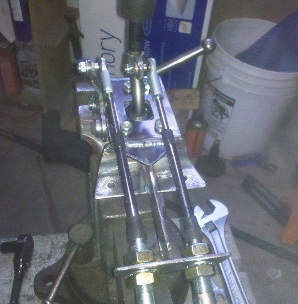

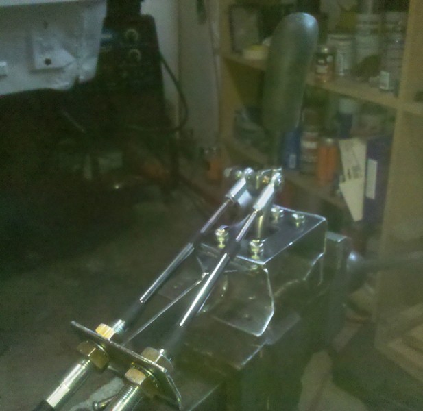

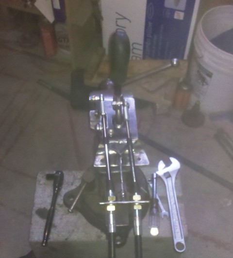

I have been studying the pics of DBCooper's (Paul) awesome build and tried to copy his version of the cable shifter. I had some cables made from a company in the mid west and used some scrap metal from an old Seagrave fire engine for the shifter linkage!
So, here is the fruit of my MAN SKILLZ! (novice that they may be (IMG:style_emoticons/default/piratenanner.gif) )
Top down view
Looks kinda familiar (IMG:style_emoticons/default/beer.gif)
Still need to paint it up

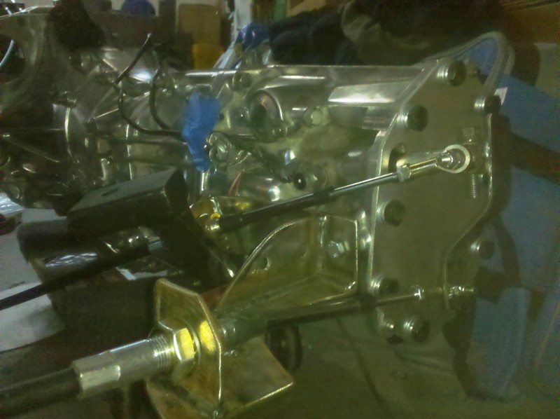

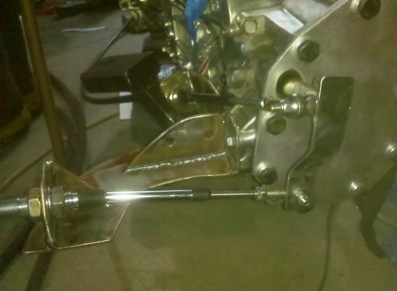

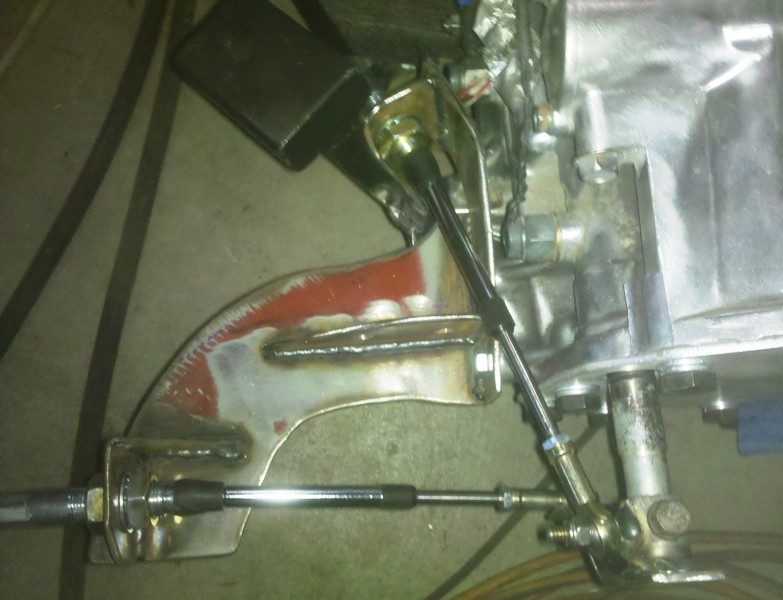

I was able to play with a plasma cutter at the fire mechanic shop for the first time and boy that thing is awesome! (IMG:style_emoticons/default/welder.gif)
Cable shifter using an MR2 linkage
another
I still need to mount it in the car and make it pretty but, I am very proud of myself considering I have never done this before! (IMG:style_emoticons/default/beerchug.gif)
