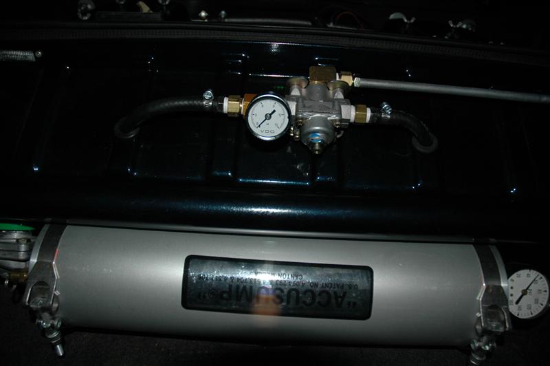

I've got a 3.0 with webers and mounted my pump up front. It's a facet blue top. Not the small facet. Althought I have a fuel cell it's mounted below where the stock tank would go. I have a Fram filter between the cell and pump. I made a steel line from the pump through the tunnel to the engine compt. This was done before any ss kits were on the market. Check with Chris Foley at Tangerine Racing he can make the ss line with an fittings. You'll just need one unless you plan a return line. A fuel regulator near the carbs would be good too...Here's the regulator/pressure gauge.
