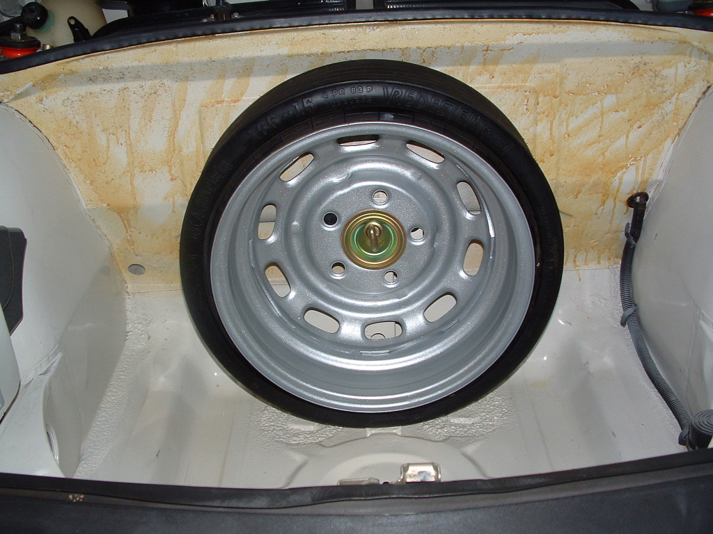

Thanks for all the great responses guys. I guess the pump will go up front after all. I'll need to get creative since I mounted my spare tire against the rear wall of the trunk last weekend....
(IMG:http://www.914world.com/bbs2/uploads_offsite/i954.photobucket.com-11663-1290650795.1.jpg)
Out of curiosity, where are y'all drawing your switched power from? I assume you need to run a line directly from the battery to a relay? No? Does the pump draw too much amperage to run it off the fuse box? Any help is greatly appreciated.
