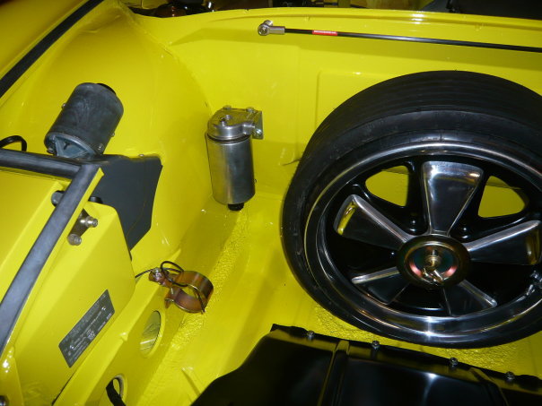

Rob... this may give you an idea:
(IMG:http://www.914world.com/bbs2/uploads_offsite/sphotos.ak.fbcdn.net-1110-1290903765.1.jpg)

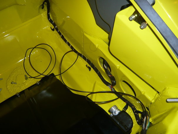

I ran a factory black/red wire into the loom:
(IMG:http://www.914world.com/bbs2/uploads_offsite/sphotos.ak.fbcdn.net-1110-1290903766.2.jpg)

Eric_Shea   Rob... this may give you an idea: http://www.914w...   Nov 27 2010, 06:22 PM
moparrob   Wow, that's really clean Eric. Did you just gr...   Nov 27 2010, 06:49 PM
Eric_Shea   Thanks Rob, There's a ground buss behind the ...   Nov 27 2010, 08:01 PM
