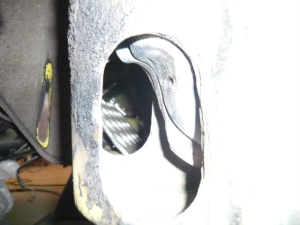

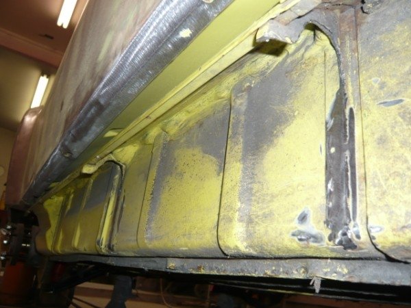

Cooler Lines - In the second picture (previous post), follow the loom to the firewall. Look below where the loom enters... there you'll see the mouse door for the lines. They are modified early 911S lines as per factory GT's. They'll run through the drivers footwell into hardlines going down the rockers. Again, all as a GT would have it. I hope to get the lines this week so I can snap some more pictures.

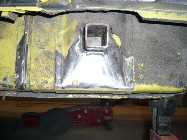

My jack post was modified for the hard lines:
(IMG:http://www.914world.com/bbs2/uploads_offsite/sphotos.ak.fbcdn.net-1110-1290909701.1.jpg)
The sill supports were modified for the lines as well:
(IMG:http://www.914world.com/bbs2/uploads_offsite/sphotos.ak.fbcdn.net-1110-1290909702.2.jpg)
Here's the hole going into the drivers side foot well:
(IMG:http://www.914world.com/bbs2/uploads_offsite/sphotos.ak.fbcdn.net-1110-1290909703.3.jpg)
