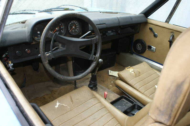

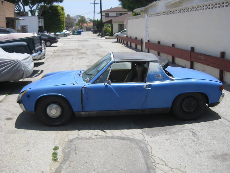

These are the first pics I saw, back in June on craigslist. The guy I got it from had bought it from a police auction on the holiday. (IMG:style_emoticons/default/smoke.gif) and they paint the date of the auction (?) on the window. I bought it now'ed off eBay for $1250. I probably could have got it for $900 if I'de have got to it sooner. There were already bids for it up to $750. I'd driven all the way up to Santa Monica in my bus and back, 60 miles, and despite what anyone might say, I think it was worth it. The guy's shop was at 2420 Lincoln (IMG:style_emoticons/default/biggrin.gif) "bought it now"-ed, after having driven 60 miles to see it and back.
(IMG:http://www.914world.com/bbs2/uploads_offsite/www.914club.com-11782-1291418830.3.jpg)

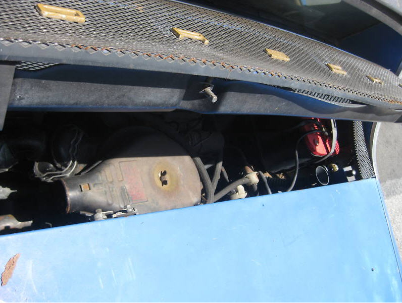

Original engine djet "will run when given starting fluid" is what the craigslist ad said.
(IMG:http://www.914world.com/bbs2/uploads_offsite/www.914club.com-11782-1291418831.4.jpg)

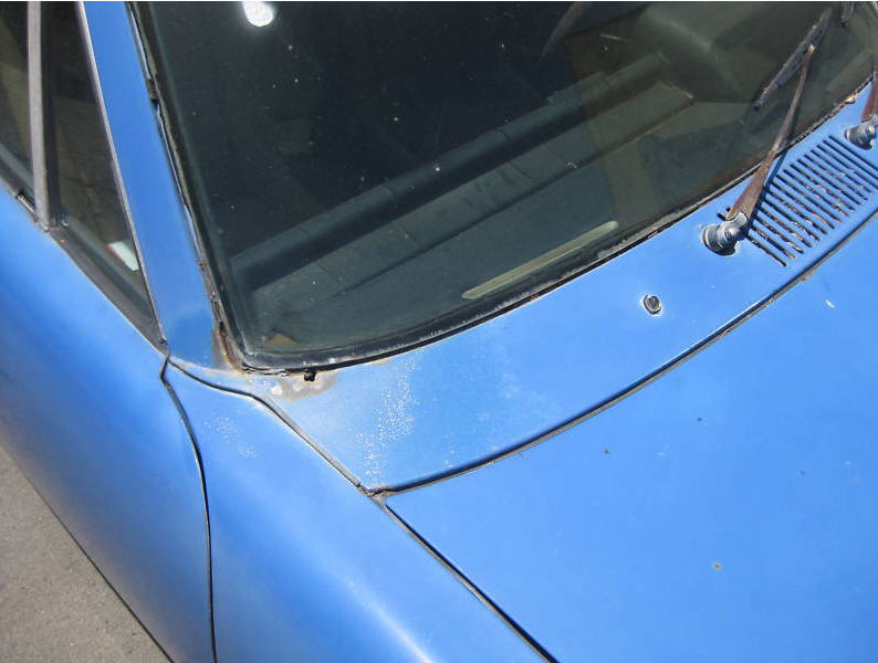

The driver door is nasty-looking. At first I thought someone had hyperextended it reversing into something while it was open, but I think it may have come open rounding a corner, flew open, and got damaged that way. At one point I was thinking just find a door of the same color, and drive her. But of course that was not to be.
The hole right there is the tip of the ice berg

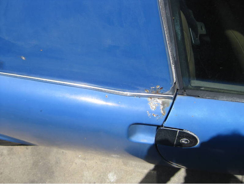

(IMG:http://www.914world.com/bbs2/uploads_offsite/www.914club.com-11782-1291418831.7.jpg)
Another iceberg
