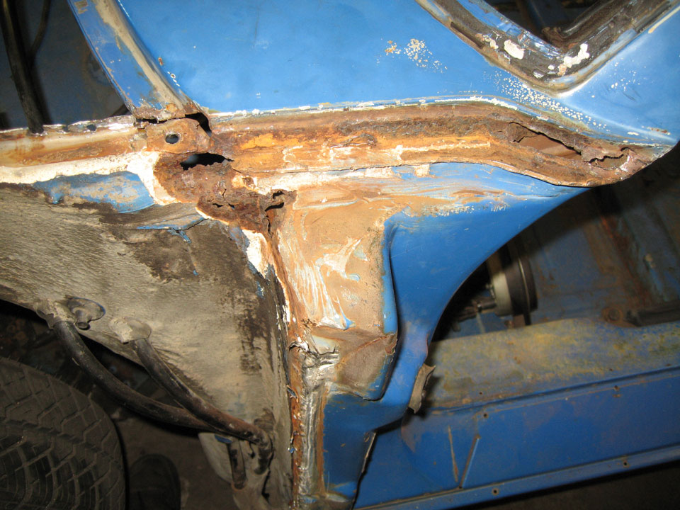

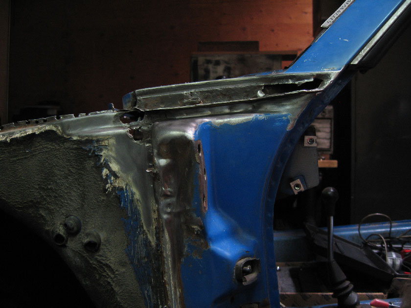

I've been stalling on updating the blog in hopes of giving the impression that I'm moving right along, when in fact I have been a bit stuck on my hell hole. I'm gonna get the metal to brace it at the doors this weekend, I think, put that together next week, and get the major cutting started probably next weekend. (IMG:style_emoticons/default/boom.gif)

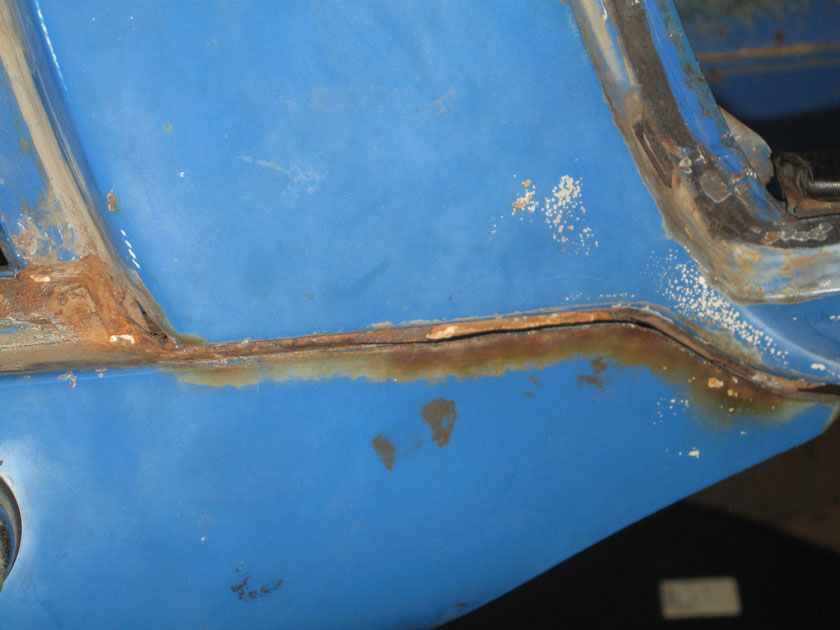

But for now, here's some madness I performed on my rusty-looking cowl/ fender/ door frame.
(IMG:http://www.914world.com/bbs2/uploads_offsite/www.914club.com-11782-1291419166.1.jpg)

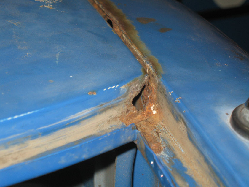

Another shot. This side actually looks better than the passenger side. (IMG:style_emoticons/default/icon8.gif)
(IMG:http://www.914world.com/bbs2/uploads_offsite/www.914club.com-11782-1291419166.2.jpg)

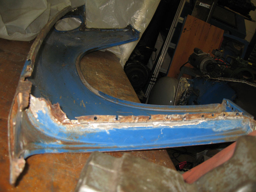

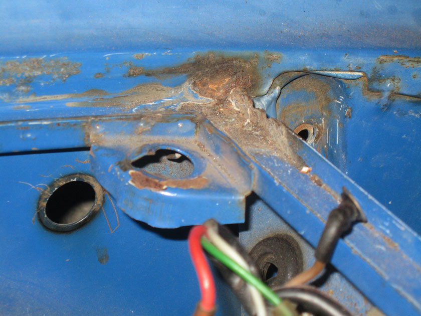

It's gotten below, to the inner fender well
(IMG:http://www.914world.com/bbs2/uploads_offsite/www.914club.com-11782-1291419167.3.jpg)

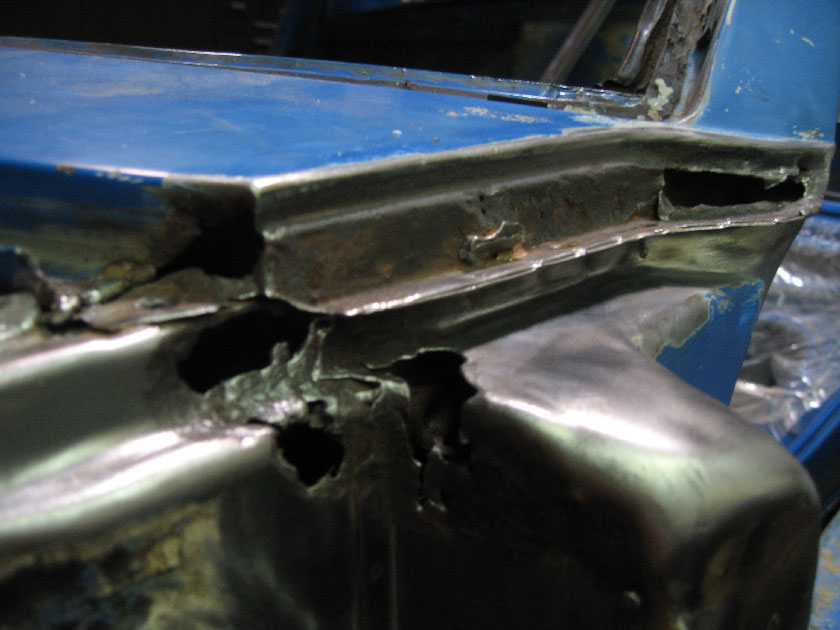

(IMG:http://www.914world.com/bbs2/uploads_offsite/www.914club.com-11782-1291419167.4.jpg)

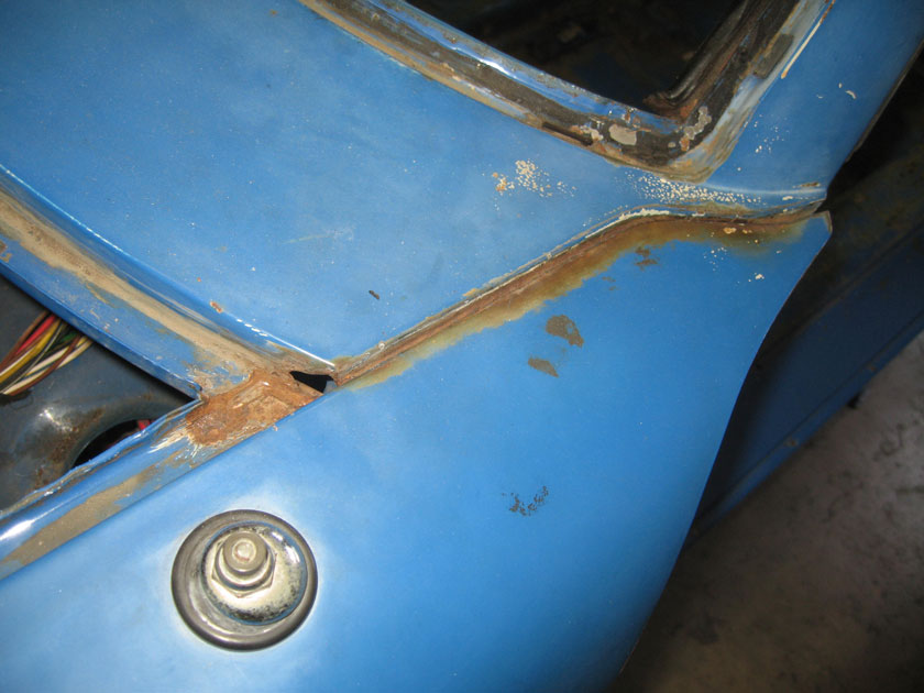

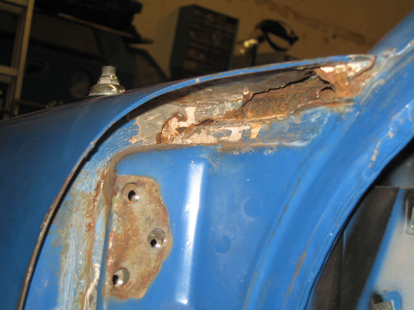

Some nastiness at the corner of the headlight bucket where the front lid seal goes.. Now just how did they expect water to exit from there?
(IMG:http://www.914world.com/bbs2/uploads_offsite/www.914club.com-11782-1291419168.5.jpg)
Water made its own way
(IMG:http://www.914world.com/bbs2/uploads_offsite/www.914club.com-11782-1291419168.6.jpg)
I didn't get shots of this before I scraped out all the sealer, but I can tell you it looked pretty decent hidden by the inches of the white stuff all dressed up in paint.
(IMG:http://www.914world.com/bbs2/uploads_offsite/www.914club.com-11782-1291419168.7.jpg)
So I contemplated for a few weeks what to do about all that, so many layers all coming together in a rusty mess right there, and both sides to be taken care of. Thought about cutting out just what seemed bad, but the challenge of getting it all back together and the fear of not going deep enough, I opted to remove the entire fender. (IMG:style_emoticons/default/screwy.gif) (IMG:style_emoticons/default/smash.gif)

They sure put the sealer on thick, about an inch of it there

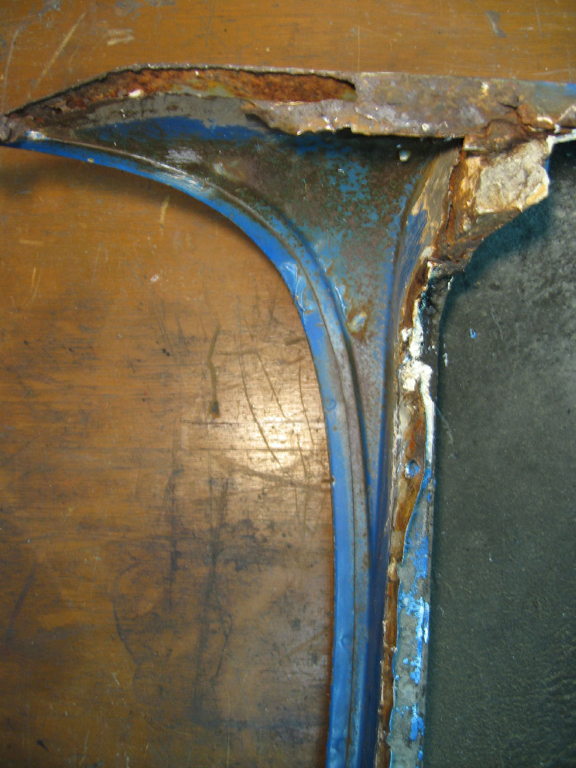

A close up. -not done, of course, but better. You can see what's going on at least without all the rusty rusty
(IMG:http://www.914world.com/bbs2/uploads_offsite/www.914club.com-11782-1291419169.10.jpg)

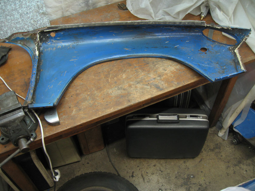

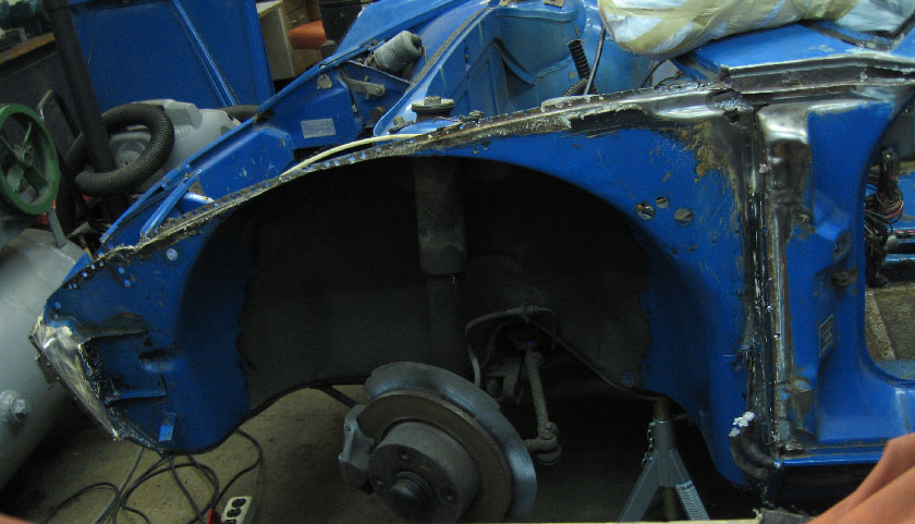

Some of the undercoat removed, some more to go. I straghtened the lip with hammer and dolly.
(IMG:http://www.914world.com/bbs2/uploads_offsite/www.914club.com-11782-1291419170.11.jpg)
Same for the fender itself :aktion035:
(IMG:http://www.914world.com/bbs2/uploads_offsite/www.914club.com-11782-1291419170.12.jpg)
