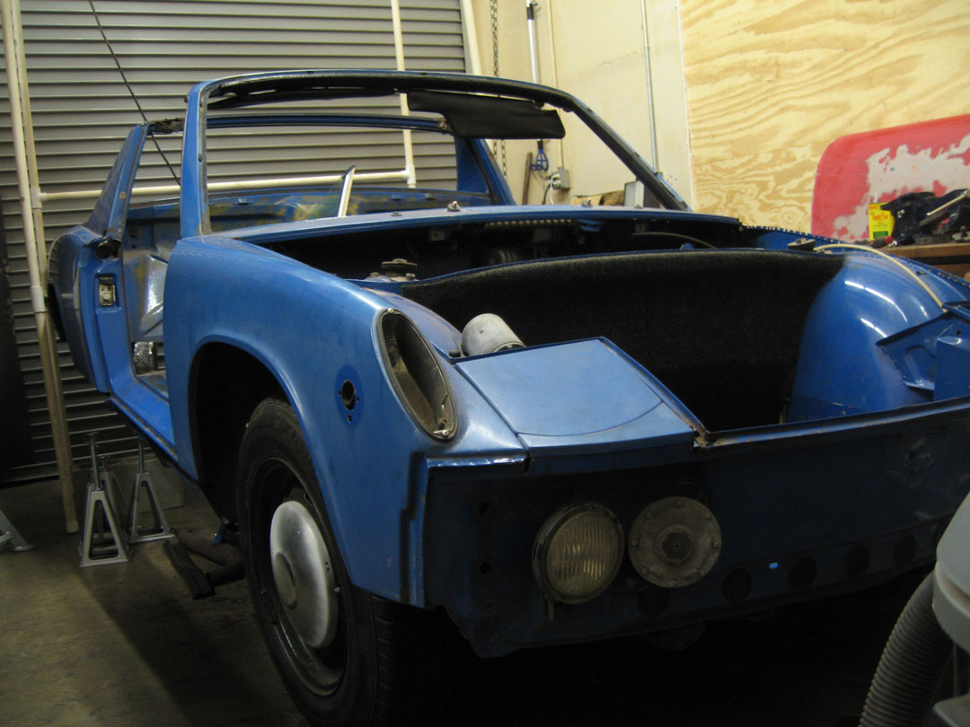

(IMG:http://www.914world.com/bbs2/uploads_offsite/www.914club.com-11782-1291418830.1.jpg)
I changed the title of the thread, so it's incognito now. (IMG:style_emoticons/default/wink.gif)
- Sort of to do with the midengined-ness, my username, and of course the 420 914 thing. (IMG:style_emoticons/default/smoke.gif)
The car was very original, but quite trashed when I bought it. It's a 49 state car, purchased in Colorado judging by the sticker that was on the back opposite the badge, Bob Hagestad Dealerhip. I don't have a picture of that unfortunately... Both bumpers had 1975 UCLA parking permit stickers.
It is an appearance group car, tan square weave, late enough to get 2 real tan basket weave seats. Original adriatic blue paint, no repaints. The snowplow early rear valence. It has the original red heater lever pull which I don't see very much. Everything was there without having been hacked/modified (besides the door panels). Unmodified but fairly trashed.
Chassis # 174932
-Meaning the chassis was built the 17th week of the year 1972 (I think it is the 17th week with a Monday the way they count it), the 4th day of that week, Thursday April 27th, 1972. -I thought it was 4/20 but I must concede it was probably a week later, the chassis production.

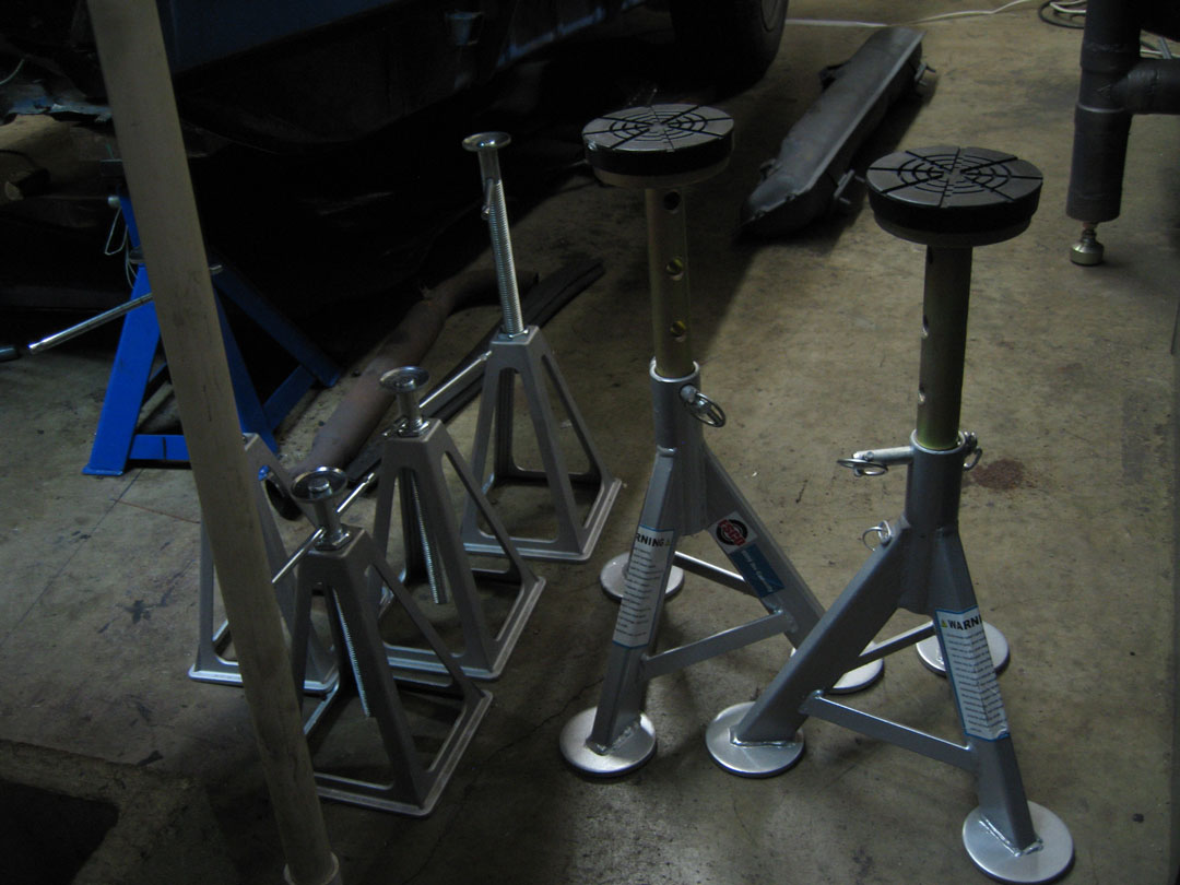

So first things first, like many-a-914, put her up on jack stands.
I had a bit of a mental dilemma about it initially. I had a dream where the car was up on my dad's lift back in Buffalo. My (now ex) girlfriend was under there with me, like bracing it. She was using this screw jack thing. She's like, "all set!" and I look back to my horror that she's suspended the car from the anti-sway bar (I don't have an anti-sway bar). I'm like, "get out from under there!", but before there was any time to for anything, the car came down right on top of her. Somehow I got He-man strength in this part of the dream and was able to fairly easily lift/ throw the car right off her, but it was too late. Totally fucking traumatizing, I can assure you, holding your crushed (ex) girlfriend's lifeless body in your arms.
This was the day after the leveling stands came in the mail and a day before the flat tops came.
(IMG:http://www.914world.com/bbs2/uploads_offsite/www.914club.com-11782-1291419439.1.jpg)
The sticker on the side of those pretty much invalidates the whole premise of a flat top jack stand. What it says is, in rather uncertain terms, not to lift up both ends of a car at the same time. So, if you're lifting one end only, pretty much everything flat on the bottom of the car would be at some angle, only the very corner of the pad would be supporting anything, and the whole stand would seemingly want to fall over I should think. The very reason I got them was with this end in mind, to get the whole thing up. It took me like days of pondering and forum posts and research to get over the dream and do the deed.
It turns out that pretty much any jack stand on the market has this same lame disclosure:
http://www.norcoind.com/norco/downloads/manuals/JackStand_Manual.pdf ://http://www.norcoind.com/norco/downl...and_Manual.pdf ://http://www.norcoind.com/norco/downl...and_Manual.pdf ://http://www.norcoind.com/norco/downl...and_Manual.pdf
Although jack stands are individually rated, they are to be used in a matched pair to support one end of a vehicle only. Stands are not to be used to simultaneously support both ends or one side of a vehicle. :bs:
(IMG:http://www.914world.com/bbs2/uploads_offsite/www.914club.com-11782-1291419444.2.jpg)
The flat ones are in front; I had this set previously. Funny that they are color matched to the car. (IMG:style_emoticons/default/happy11.gif)

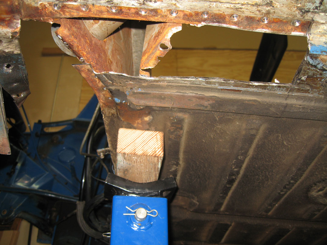

First here
(IMG:http://www.914world.com/bbs2/uploads_offsite/www.914club.com-11782-1291419447.3.jpg)

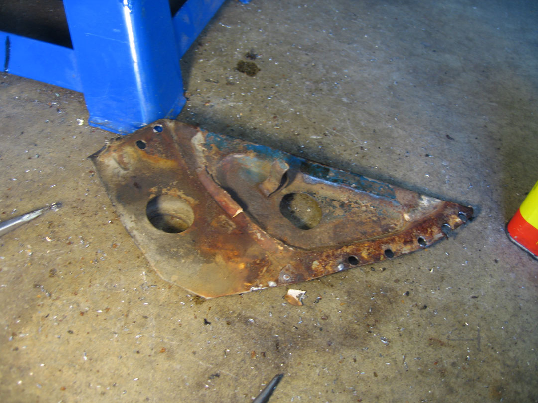

and then here when I got the jack point
(IMG:http://www.914world.com/bbs2/uploads_offsite/www.914club.com-11782-1291419453.4.jpg)

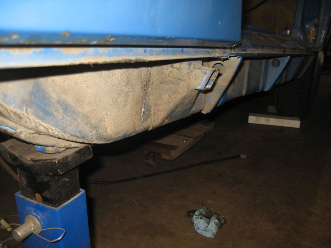

off
(IMG:http://www.914world.com/bbs2/uploads_offsite/www.914club.com-11782-1291419462.5.jpg)
