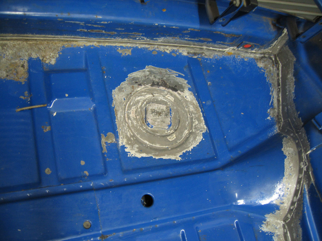

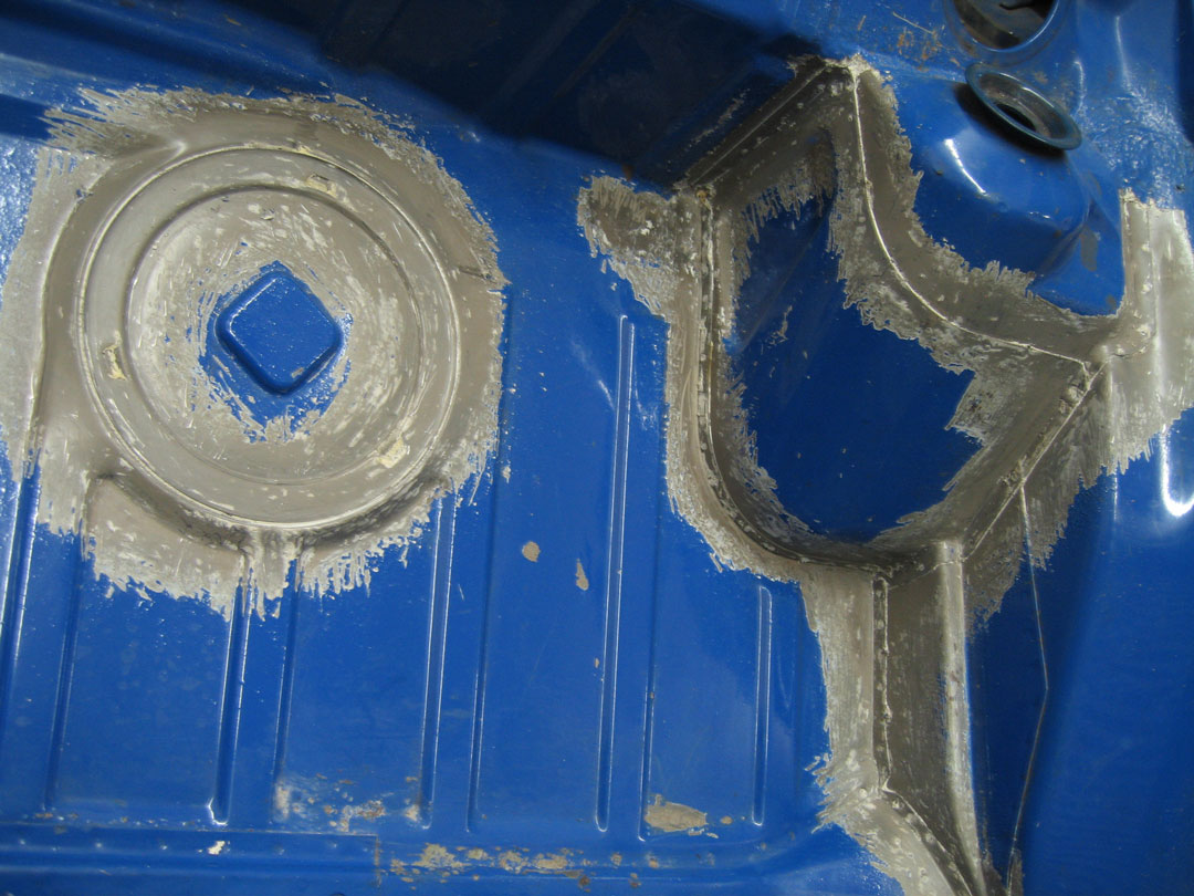

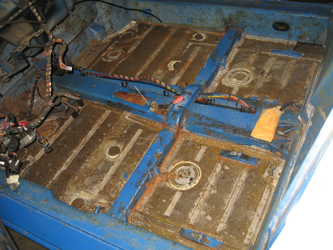

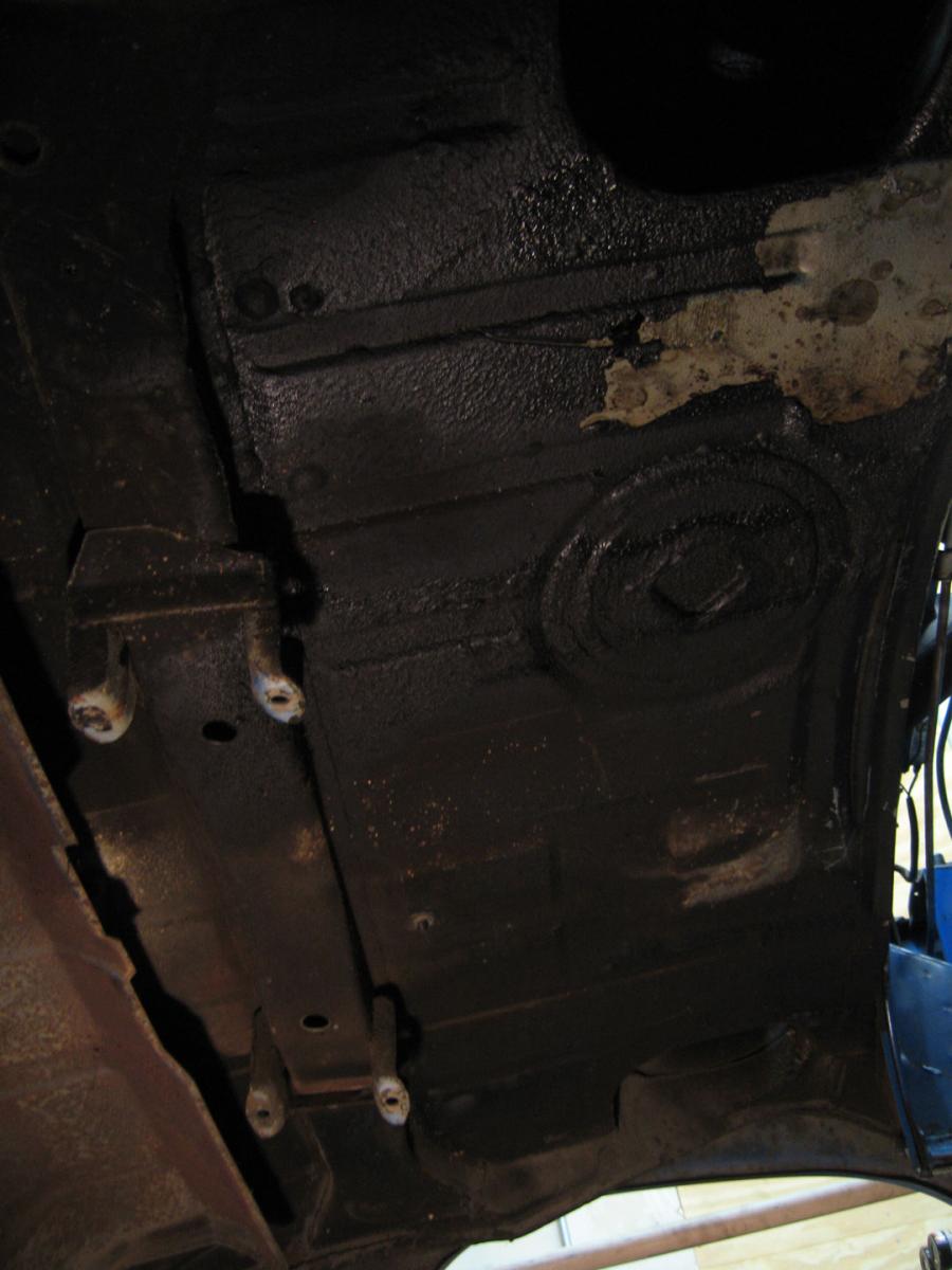

Unbelievable how much undercoat was used at the factory on these cars. My bus isn't built like that, thank god! What where they thinking? -probably about sound dampening. (IMG:style_emoticons/default/screwy.gif)
I read that the cars delivered to Porsche for completion as 6's, the sealer was applied a lot less liberally and by hand. I'm planning on using a brush on epoxy seam sealer more like a 6. Forget this gobs of bumpy white rubbery crap. With it being softer than the paint on top of it, there's no wonder there are so many problems.
The slightest penetration, the tiniest breach in the paint shell, sometimes unnoticeable on the surface even, would create a sort of spider of rust radiating out from it underneath. I'm scraping it ALL off, me my heat gun and my big dull screwdriver (IMG:style_emoticons/default/happy11.gif)
I don't have a pic of what the rear trunk originally looked like, a bit of surface rust at the back. Here's a pic of it after the initial scraping (quite conservative compared to stage 2 (IMG:style_emoticons/default/ar15.gif) ) The trunk did not come with this pristine pair of ssi heater boxes, unfortunately, I had to put them in there. :-) I don't seem to have a more relevant picture of pre stage 2 for some reason.
(IMG:http://www.914world.com/bbs2/uploads_offsite/www.914club.com-11782-1291419587.1.jpg)
-They're hard not to look at aren't they? (IMG:style_emoticons/default/hijacked.gif)
This took me awhile
(IMG:http://www.914world.com/bbs2/uploads_offsite/www.914club.com-11782-1291419588.2.jpg)
(IMG:http://www.914world.com/bbs2/uploads_offsite/www.914club.com-11782-1291419589.3.jpg)
(IMG:http://www.914world.com/bbs2/uploads_offsite/www.914club.com-11782-1291419590.4.jpg)

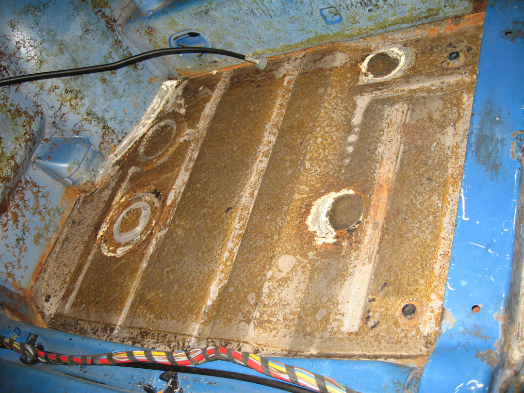

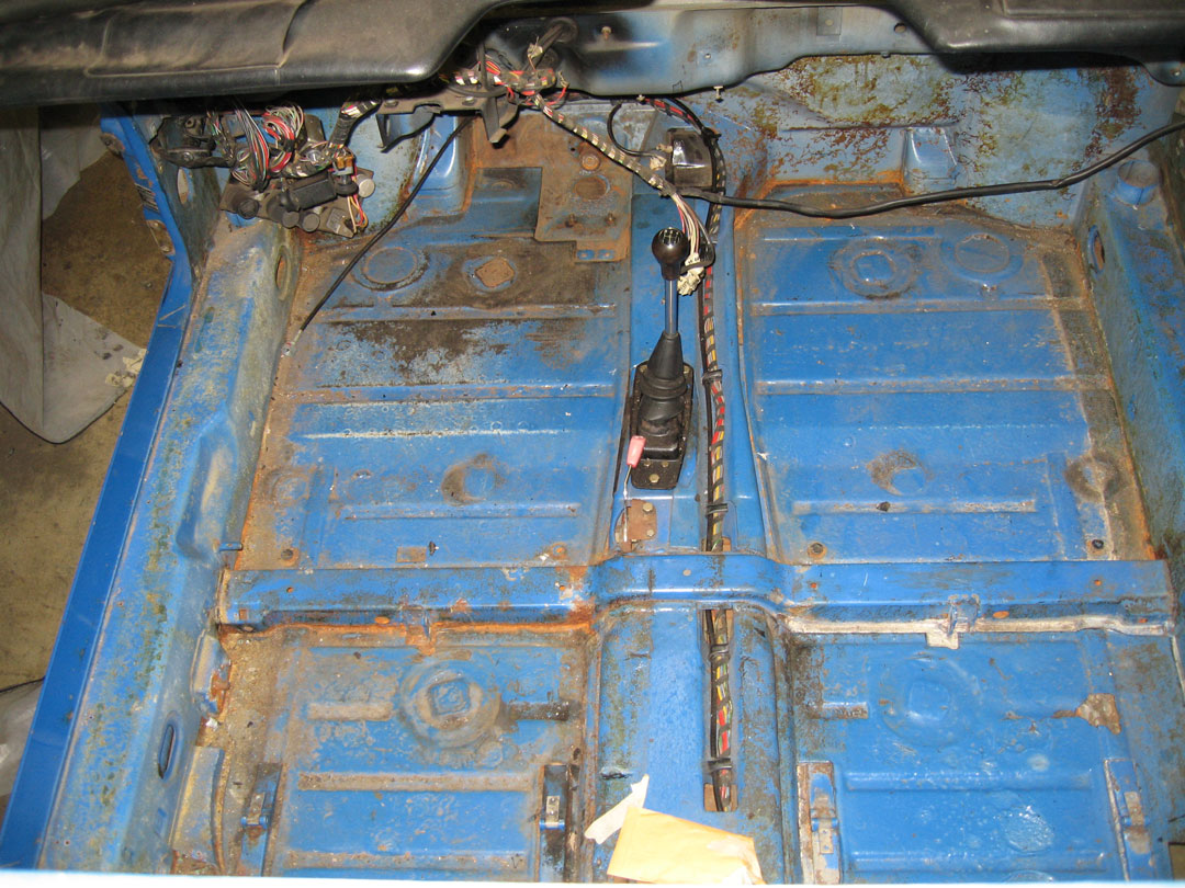

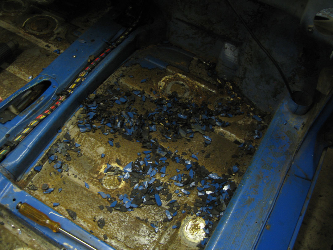

The thick-ass tar on the floor of the interior may have taken longer even. I got a few blisters getting that shite out. Here's before:
(IMG:http://www.914world.com/bbs2/uploads_offsite/www.914club.com-11782-1291419591.5.jpg)

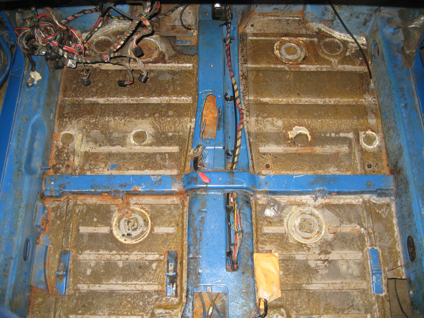

and after
(IMG:http://www.914world.com/bbs2/uploads_offsite/www.914club.com-11782-1291419594.6.jpg)
(IMG:http://www.914world.com/bbs2/uploads_offsite/www.914club.com-11782-1291419597.7.jpg)
(IMG:http://www.914world.com/bbs2/uploads_offsite/www.914club.com-11782-1291419598.8.jpg)

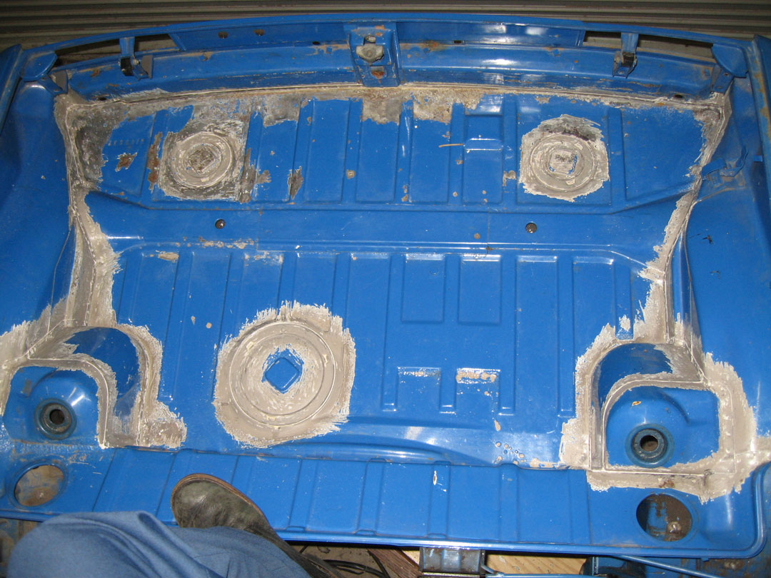

That's the weapon of choice right there, Made in Taiwan. (IMG:style_emoticons/default/post-2-1117899824.gif) It is full-tang though. It got so intense, the scrapin' scrapin' scrapin' that the tang started to slide in the handle, pushing the impact plate out the back of it periodically. -Still the weapon of choice though, the tip has been through so much scraping
(IMG:http://www.914world.com/bbs2/uploads_offsite/www.914club.com-11782-1291419598.9.jpg)
it'll take of undercoat without (barely) damaging the paint beneath.
(IMG:http://www.914world.com/bbs2/uploads_offsite/www.914club.com-11782-1291419600.10.jpg)
(IMG:http://www.914world.com/bbs2/uploads_offsite/www.914club.com-11782-1291419601.11.jpg)
Some paint thinner will make it look pristine under there. I can't wait to take off the exhaust heat shield.
