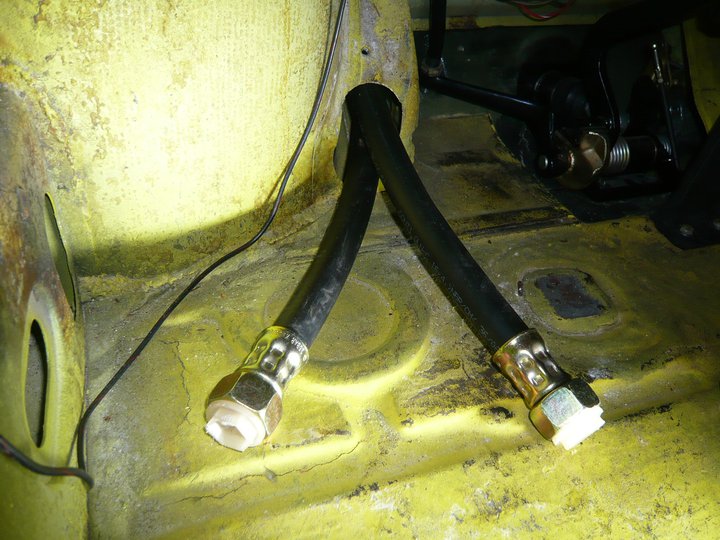

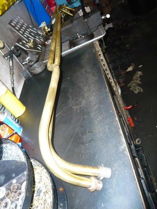

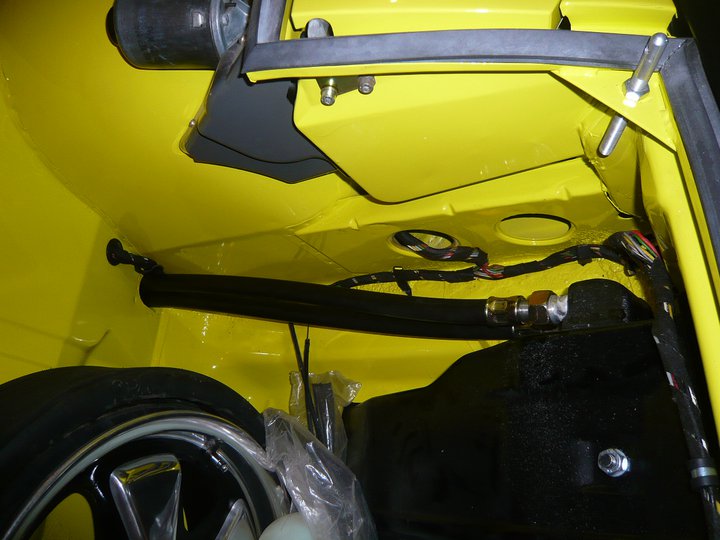

Also, at what point in the front trunk did you end up running your cooler lines through? I just bought an RX-7 cooler and welded AN -12 fittings to it and am trying to determine the best place to run the (braided nylon) -12 hoses back to the thermostat. I see that some guys run them low, by the trunk floor and some guys run them pretty high up.
I'm pretty sure I want to run the lines under the rocker panels, but am open to suggestions.
Lines came in today...
Hardlines:

Softlines:

Into the cabin:

moparrob   Nice setup Eric. Is the hard line going to protru...   Dec 4 2010, 04:15 AM
Eric_Shea   Yes, they come through the holes shown before. ...   Dec 4 2010, 09:49 AM
