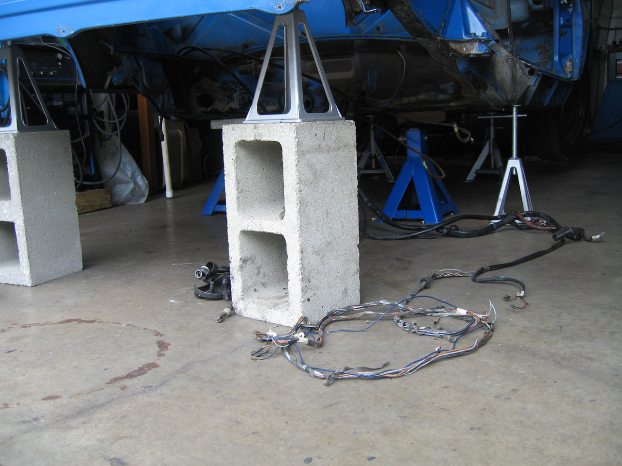

QUOTE(nathansnathan @ Dec 3 2010, 03:40 PM) *
Please put that concrete block on the floor oriented the way it would be installed in wall with a 2x8 on top of it, or better yet get rid of it all together. Any imperfection in that block, and/or the orientation of it as pictured, and down comes car...
Keep up the good work, it is gonna be fun to watch the progress (IMG:style_emoticons/default/smilie_pokal.gif)
Jim
nathansnathan
post Dec 5 2010, 05:19 PM
Posts: 1,052
Joined: 31-May 10
From: Laguna Beach, CA
Member No.: 11,782
QUOTE(roadster fan @ Dec 4 2010, 01:26 PM) *
Jim

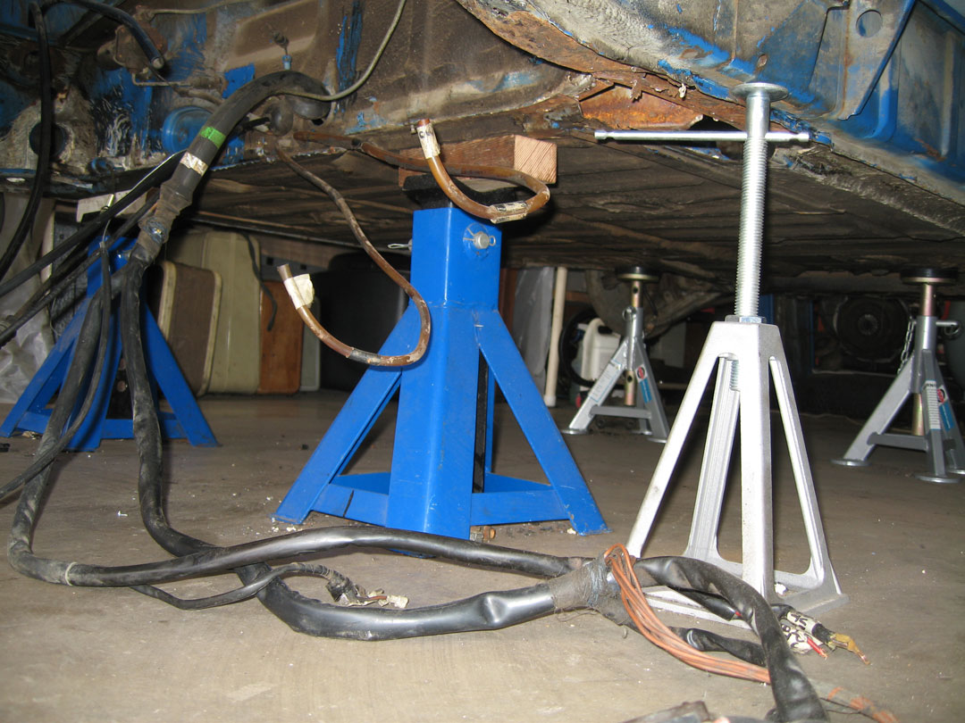

I've said this same thing to a guy an the bus furum at the samba, and I agree that having superfluous jack stands are not so good an idea. -I wouldn't ever think of supporting the car back there btw; those are there in prep for what's next.
The car is held up thusly:
(IMG:http://www.914world.com/bbs2/uploads_offsite/www.914club.com-11782-1291591184.1.jpg)
and then I've got trailer levelers to hold up the trunk only. I wouldn't trust these to hold the car up even though they say they are rated for it. Actually the back end I can probably lift up in it's entirety with my bare hands, it is that light.
The cinder blocks with the trailer levellers are to keep the trunk from sagging when I take off the rear fender(s). -I don't have a jig; I think it'as mostly only going to be able to go together 1 way.
(IMG:http://www.914world.com/bbs2/uploads_offsite/www.914club.com-11782-1291591557.1.jpg)
Anyway, I had them snugged up back there, then after I removed the fender the trunk ended up lifting up actually instead of drooping down. I've tensioned them up to that for now, as I've got more of the long to take out.
Anyway, thanks for the concern, I think it should be alright as long as the main stands are good.
