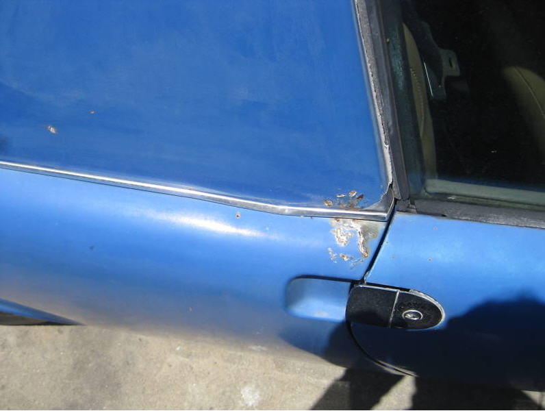

This pic is from the original eBay photos
(IMG:http://www.914world.com/bbs2/uploads_offsite/www.914club.com-11782-1291591584.1.jpg)

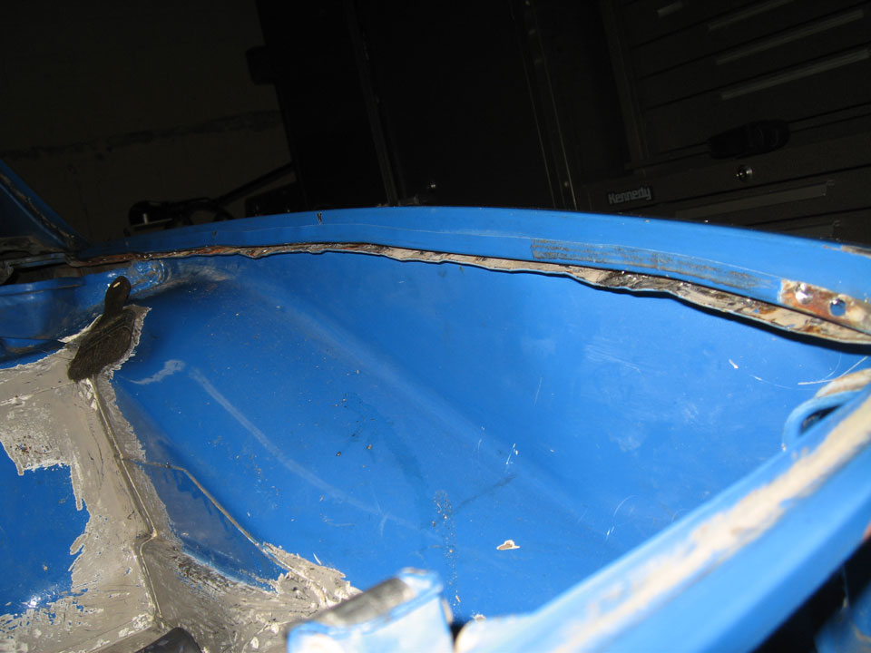

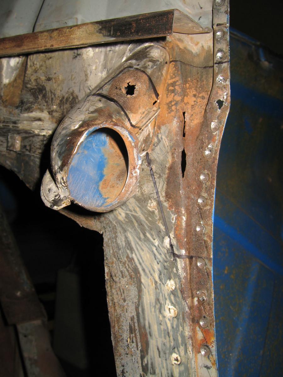

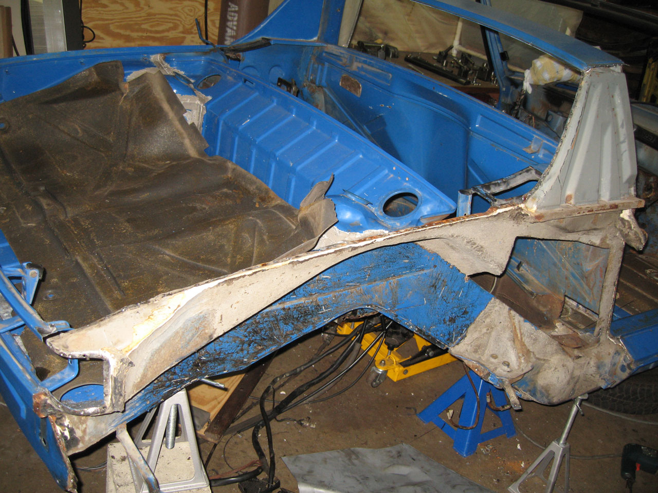

A bit of probing with my big screw driver and some preliminary cutting and I made it look extremely scary
(IMG:http://www.914world.com/bbs2/uploads_offsite/www.914club.com-11782-1291591814.1.jpg)
(IMG:http://www.914world.com/bbs2/uploads_offsite/www.914club.com-11782-1291591584.2.jpg)

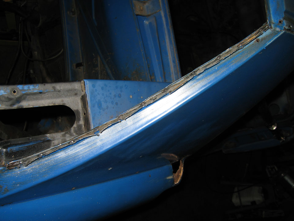

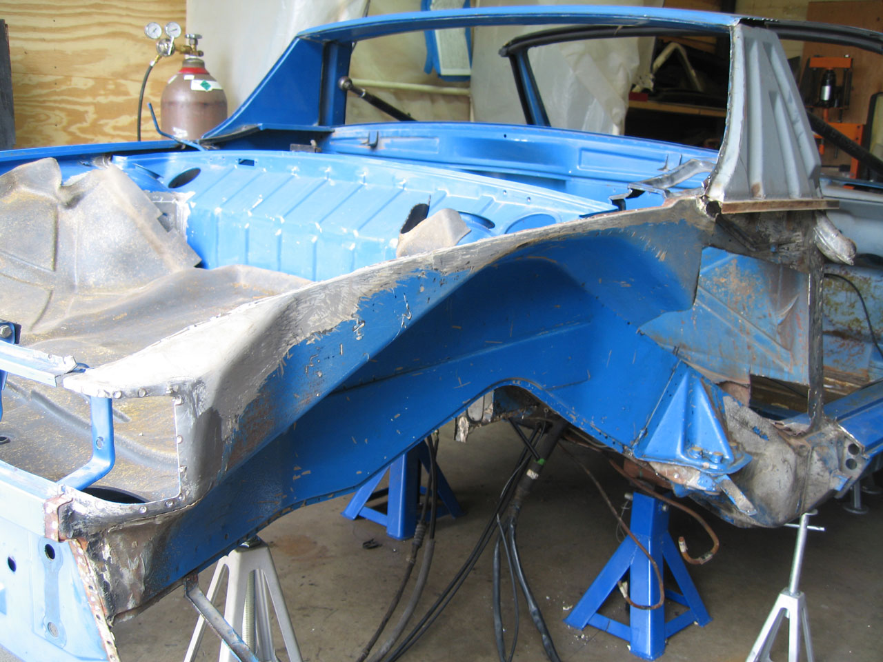

I contemplated all sorts of ways to handle this mess and, probably contrary to what anyone else would have done, decided to take off the whole fender, sail panel included. (IMG:style_emoticons/default/blink.gif)
Many spotwelds drilled, I took my time with it, taking breaks between the sections of drilling, and then the prying/ pulling. All told it probably took me 7 hours to get it off.
(IMG:http://www.914world.com/bbs2/uploads_offsite/www.914club.com-11782-1291591584.3.jpg)
(IMG:http://www.914world.com/bbs2/uploads_offsite/www.914club.com-11782-1291591585.4.jpg)
exposing the crustiness

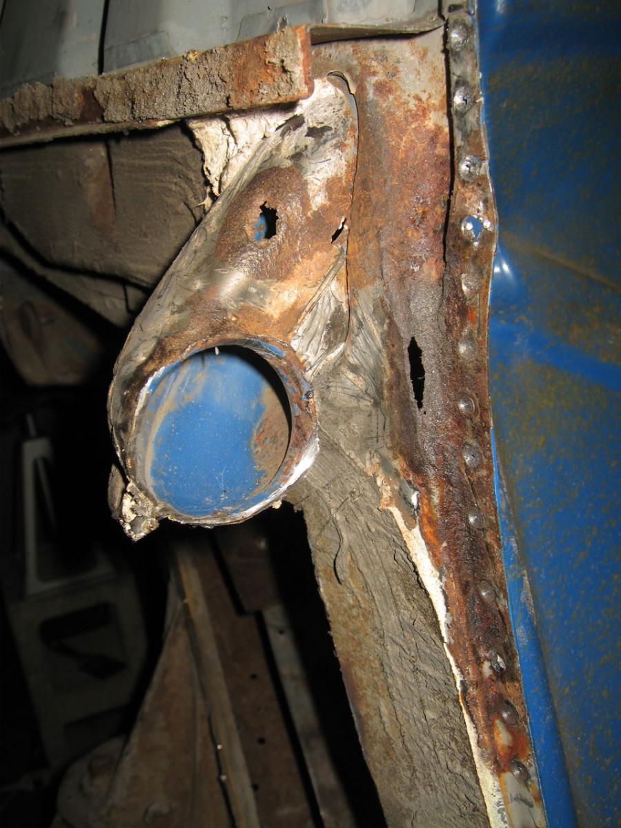

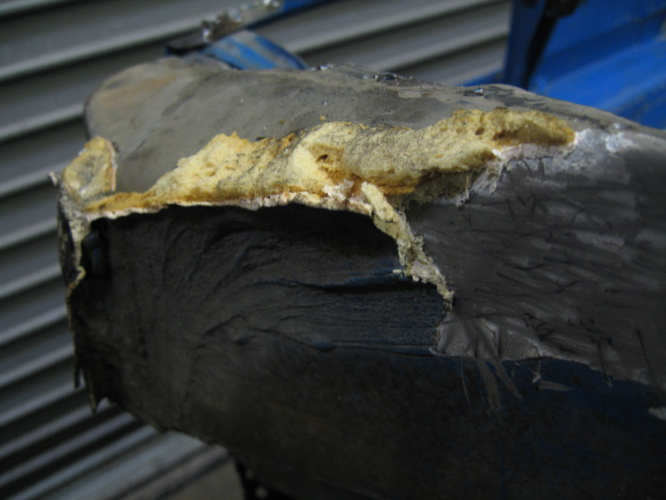

This is back by the tail light. It looks like the factory used expanding foam between the pieces there.
(IMG:http://www.914world.com/bbs2/uploads_offsite/www.914club.com-11782-1291591586.6.jpg)
And then there's like weatherstrip foam between the sail panel and the inner rollbar, still attached to that lip.
(IMG:http://www.914world.com/bbs2/uploads_offsite/www.914club.com-11782-1291591586.7.jpg)

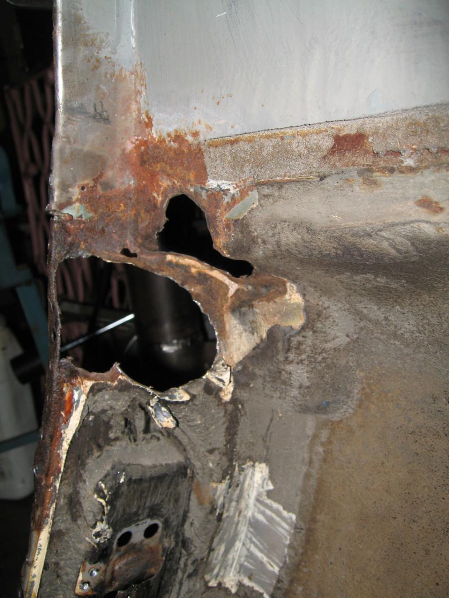

I'm going to have to get real good at the metal working pretty quick to handle all this.
(IMG:http://www.914world.com/bbs2/uploads_offsite/www.914club.com-11782-1291591587.8.jpg)

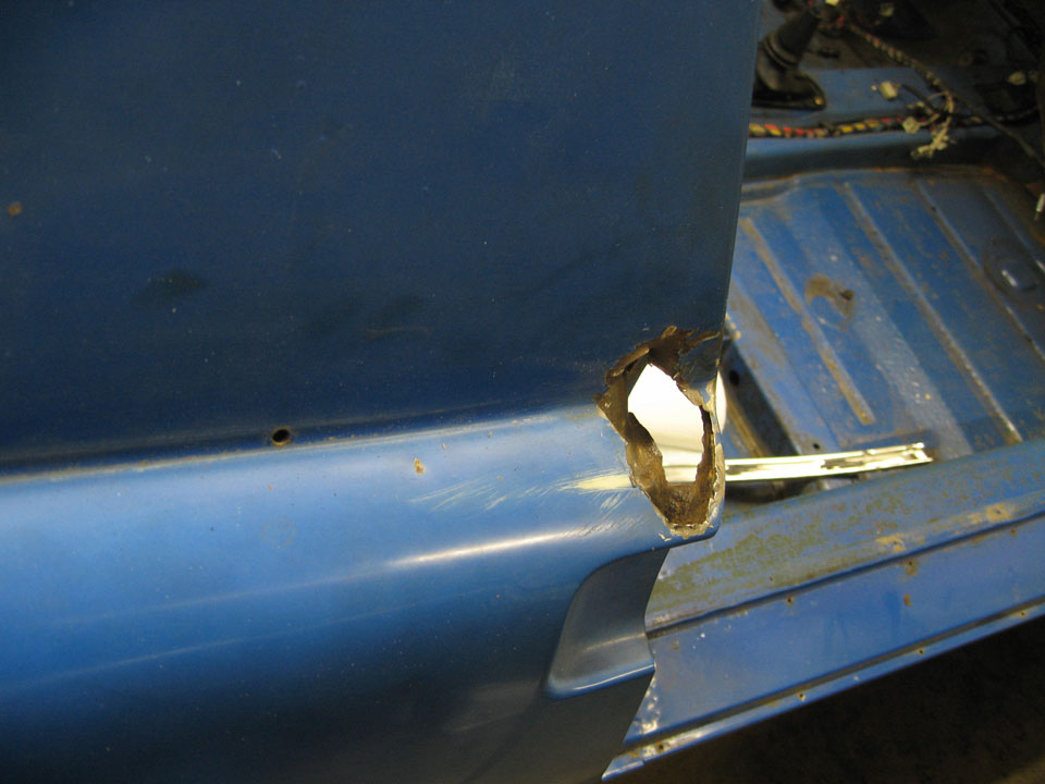

Here's the inside of the fender itself, still attached to the door well.
(IMG:http://www.914world.com/bbs2/uploads_offsite/www.914club.com-11782-1291591980.1.jpg)
More 'deep end' metal working to be done there. I'm lloking at getting a shot dolly and some planishing and ball peen hammers. I've read the Martin "key to Metal Bumping" book and I've got a set of dolllies and hammers. I was trying to get an anvil but the guy flaked out on me.
The guy down the street was telling me I need to dip the car to get where I want to be, but I have some issues with dipping it, not the least f which is price, and so taking the car apart to this level seems to me the way to go. I can do the work, inspect/ get at everything for treatment. I'm looking for a portable sand blaster pot that is NOT from harbor freight. That and construction of a drop cloth-constructed paint booth look like some of the bigger hurdles right now.

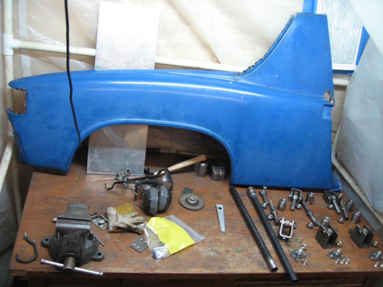

Here's the fender
(IMG:http://www.914world.com/bbs2/uploads_offsite/www.914club.com-11782-1291591987.4.jpg)
(IMG:http://www.914world.com/bbs2/uploads_offsite/www.914club.com-11782-1291591987.5.jpg)
