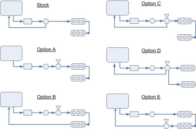

This diagram was drawn to show the different ways to put a fuel regulator in.
but it should also show some different ways to route the carb plumbing.
I use option B on the race car
note that option E is basically a factory 4cylinder set up, but could easily work on a 6 also.. and I once ran E on an old 4 cylinder race car.

moparrob   I'll be using "Option B" from the di...   Dec 5 2010, 09:52 PM
brant   I'll be using "Option B" from the d...   Dec 6 2010, 12:08 AM
Eric_Shea   I thought stock -6 pumps were set at a certain pre...   Dec 5 2010, 10:12 PM
brant   I thought stock -6 pumps were set at a certain pr...   Dec 6 2010, 12:20 AM
