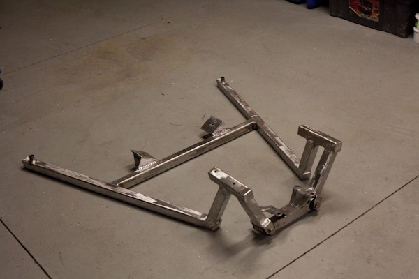

Got some more work done on the car. Engine cradle is finished, just needs powder coat. Got most of the design from DBCooper, a great design that looks good, keeps the stock suby mounts, great support fwd/aft, and is easy to install/uninstall.
trans mount with bushings

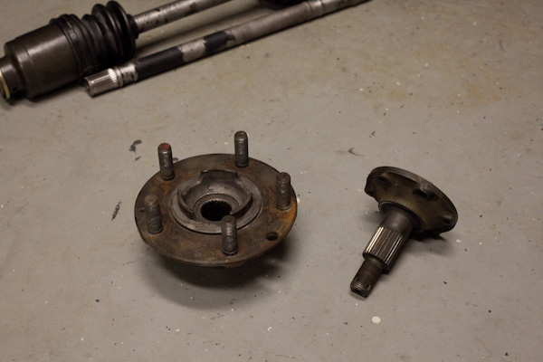

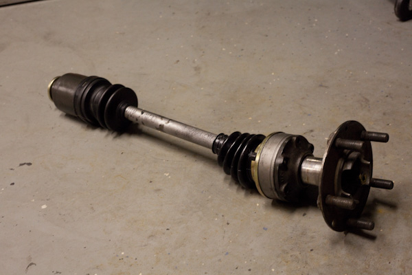

I got my re-splined 914 axles back from dutchman. I decided to do a 5-lug conversion since I'm working on axles anyway. After some hunting for the right 911 pieces it finally came together.
Suby CV -> re-splined 914 axle -> 944 CV -> '78 911 stub axle -> '70 911 hub
The '78 stub axles were the toughest part to find.
