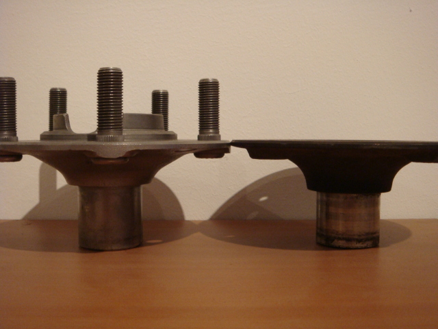

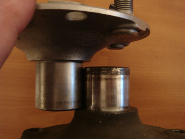

Nice setup, but I have a question: I have the same 911 5 lug hubs, but in my case the part/hub that slides into the wheel bearing is about 5mm longer then the original 914 hub shaft, so I need a 5mm spacer between the hub and stub axle to make the bearing fit snug..
simply said: the 914 bearing is less high then the part of the 911 hub that slides into the bearing...
Do you have that too?
In the meanwhile, I took a picture of what I meant:
They are the same height:
(IMG:http://www.914world.com/bbs2/uploads_offsite/i854.photobucket.com-12210-1292149921.1.jpg)
But this is the difference:
(IMG:http://www.914world.com/bbs2/uploads_offsite/i854.photobucket.com-12210-1292149922.2.jpg)
Nothing that can't be solved by machining a spacer ring.....but I was wondering if you had that same issue..
O, and my 944 stubs fit into the 911 hubs.....

sawtooth   Yeah, mine look the same as yours. That'd be a...   Dec 12 2010, 07:04 PM
charliew   Nice work. A person here makes the spacers for the...   Dec 13 2010, 11:44 AM
