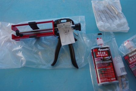

I bought this as a stripped down rolling chassis. The sller put wheels on it to get it on the trailer. That was 4 long years ago. I also had a son at the same time so working on the car has been a second priority. Now the engine is in and the brakes are on, I should be able to get some work done more quickly. I plan on firing this up within the next couple of weeks and taking on a drve by the end of July. I got the 3m adhesive today to get the fenders bonded on and then the fun stuff begins. Hope to get it completed in time for next years West Coast Ramble. Thanks to the support and motivation of the 914World. (IMG:style_emoticons/default/biggrin.gif)

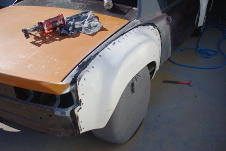

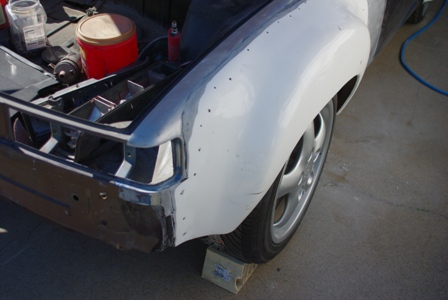

I decided I would get some of the pics up of the progress I have made the past few weeks. I will do a more detailed "how to" later and cover the steps better. Not hard to do if you follow instruction well. Solid as a rock!!! Should be easy to fill gaps. Last pic is after the edges were smoothed out. Next will be the kitty hair filler.

raw1298   Couple of different angles. It takes about a tube ...   Dec 13 2010, 10:03 AM
raw1298   The drivers side before taking off excess glue. Fr...   Dec 13 2010, 11:36 AM
raw1298   Just a couple more angles. The flares from QRS see...   Dec 13 2010, 06:22 PM

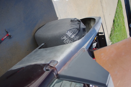

raw1298   Since it has been raining I decided to test fit th...   Dec 29 2010, 04:43 PM
raw1298   I guess I should say that I will not be bonding th...   Dec 29 2010, 05:49 PM
