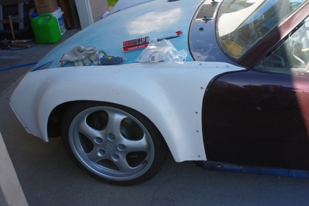

raw1298   I decided I would get some of the pics up of the p...   Dec 13 2010, 09:57 AM

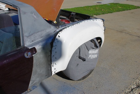

raw1298   Couple of different angles. It takes about a tube ...   Dec 13 2010, 10:03 AM
raw1298   The drivers side before taking off excess glue. Fr...   Dec 13 2010, 11:36 AM
raw1298   Just a couple more angles. The flares from QRS see...   Dec 13 2010, 06:22 PM
