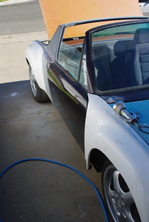

I bought this as a stripped down rolling chassis. The sller put wheels on it to get it on the trailer. That was 4 long years ago. I also had a son at the same time so working on the car has been a second priority. Now the engine is in and the brakes are on, I should be able to get some work done more quickly. I plan on firing this up within the next couple of weeks and taking on a drve by the end of July. I got the 3m adhesive today to get the fenders bonded on and then the fun stuff begins. Hope to get it completed in time for next years West Coast Ramble. Thanks to the support and motivation of the 914World. (IMG:style_emoticons/default/biggrin.gif)

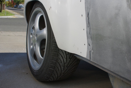

Just a couple more angles. The flares from QRS seem to fit well. It made the final bonding easier by spending many hours getting the fitting correct. I also took everything down to bare metal and then cleaned all parts with a degreaser and wax remover. A thin layer of adhesive to cover bonding area on both surfaces making sure to cover completely. Then used self tapping screws to secure. I let each flare sit a minimum 24 hours before removing screws.
raw1298   on the ground!   Jun 28 2010, 03:31 PM
RobW   :beer1: :beer1: Keep on making progress :trophy:...   Jun 28 2010, 03:33 PM
markb   WooHoo! :beer2:   Jun 28 2010, 03:34 PM
raw1298   I forgot to add the picture :wacko:   Jun 28 2010, 03:34 PM
raw1298   Another view. I love the look of the 17" whee...   Jun 28 2010, 03:52 PM
markb   Wow, you have a harlequin car. :D   Jun 28 2010, 03:54 PM
wallys914   Glad the adapters worked for ya! have fun :dri...   Jun 28 2010, 03:56 PM
raw1298   I couldn't find all the parts in the right col...   Jun 28 2010, 03:59 PM
BigDBass   Very unique color scheme. :) Now keep goin'...   Jun 28 2010, 04:01 PM
ConeDodger   I thought the decklid I gave you was Signal Orange...   Jun 28 2010, 04:02 PM
raw1298   Just for the record, 17" wheels do fit with t...   Jun 28 2010, 05:03 PM
FourBlades   That will be a killer looking car whatever color y...   Jun 28 2010, 05:10 PM
raw1298   I am leaning toward a color I saw on a scion. It i...   Jun 28 2010, 07:34 PM

raw1298   I decided I would get some of the pics up of the p...   Dec 13 2010, 09:57 AM
raw1298   Couple of different angles. It takes about a tube ...   Dec 13 2010, 10:03 AM
raw1298   The drivers side before taking off excess glue. Fr...   Dec 13 2010, 11:36 AM
raw1298   Just a couple more angles. The flares from QRS see...   Dec 13 2010, 06:22 PM
