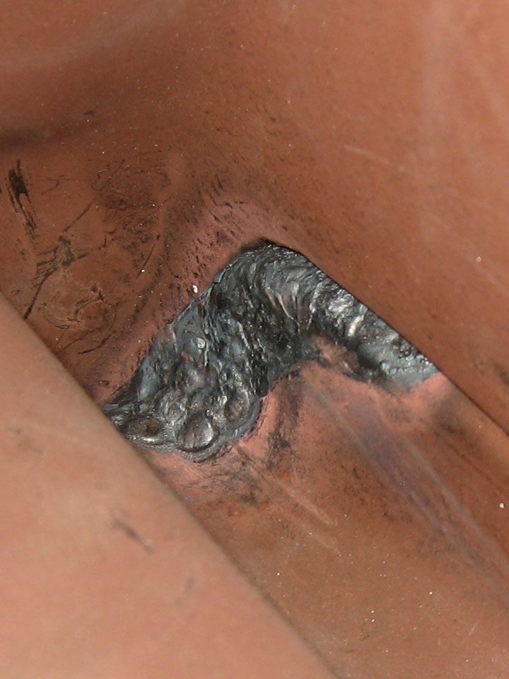

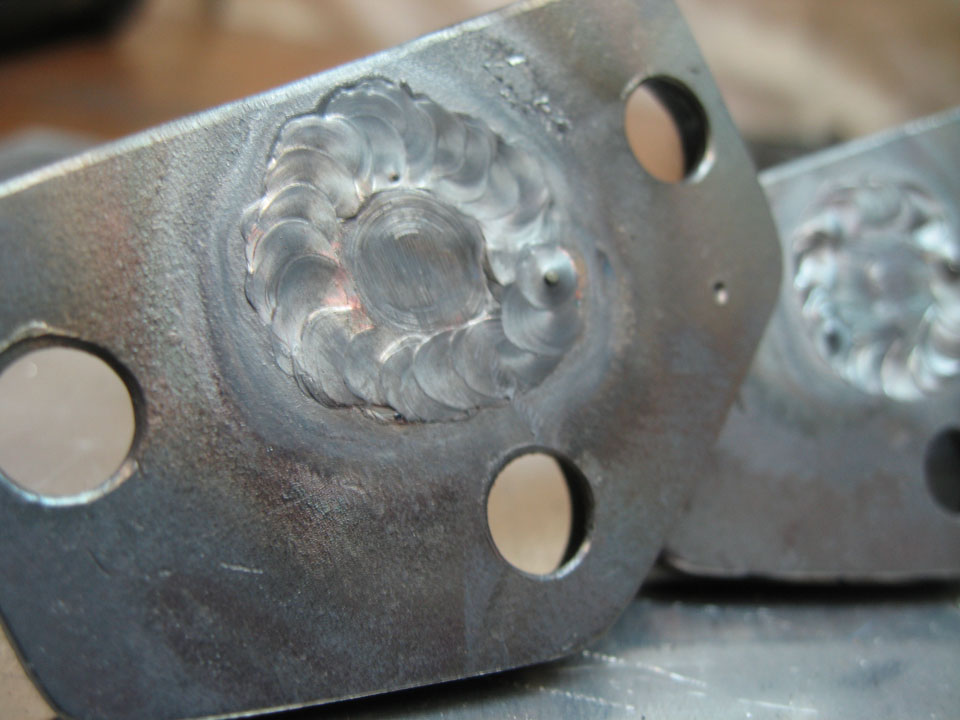

Moving slowly along, some more work on the door braces
(IMG:http://www.914world.com/bbs2/uploads_offsite/www.914club.com-11782-1292380342.1.jpg)
(IMG:http://www.914world.com/bbs2/uploads_offsite/www.914club.com-11782-1292380342.2.jpg)
Getting better with the torch. I do wish I had the smaller torch, a 9 I guess.

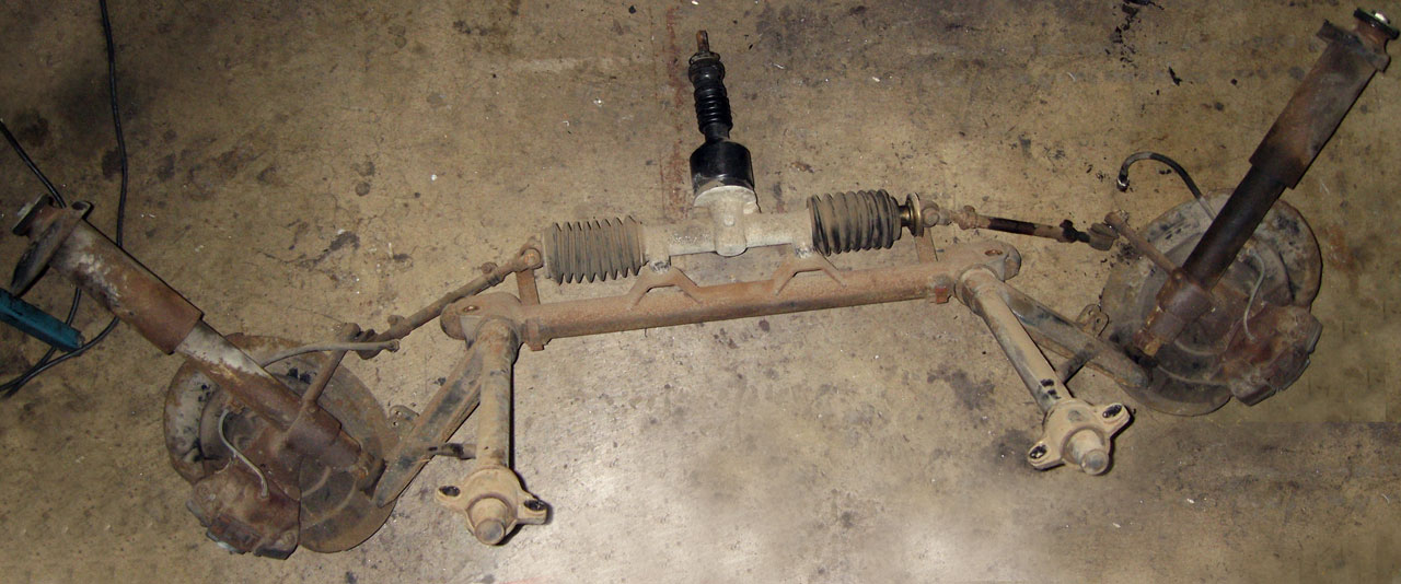

I got off the front suspension; really easy surprisingly... except the brake fluid that got everywhere.
(IMG:http://www.914world.com/bbs2/uploads_offsite/www.914club.com-11782-1292380342.3.jpg)

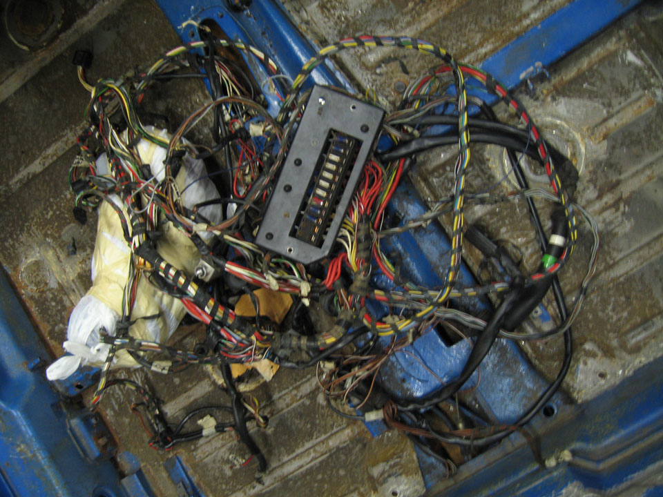

And the wiring Harness, what a challenge that was to overcome, getting that out! That's a gauge cluster in about 10 plastic grocery bags, wrapped in masking tape. (IMG:style_emoticons/default/smile.gif)
(IMG:http://www.914world.com/bbs2/uploads_offsite/www.914club.com-11782-1292380343.4.jpg)

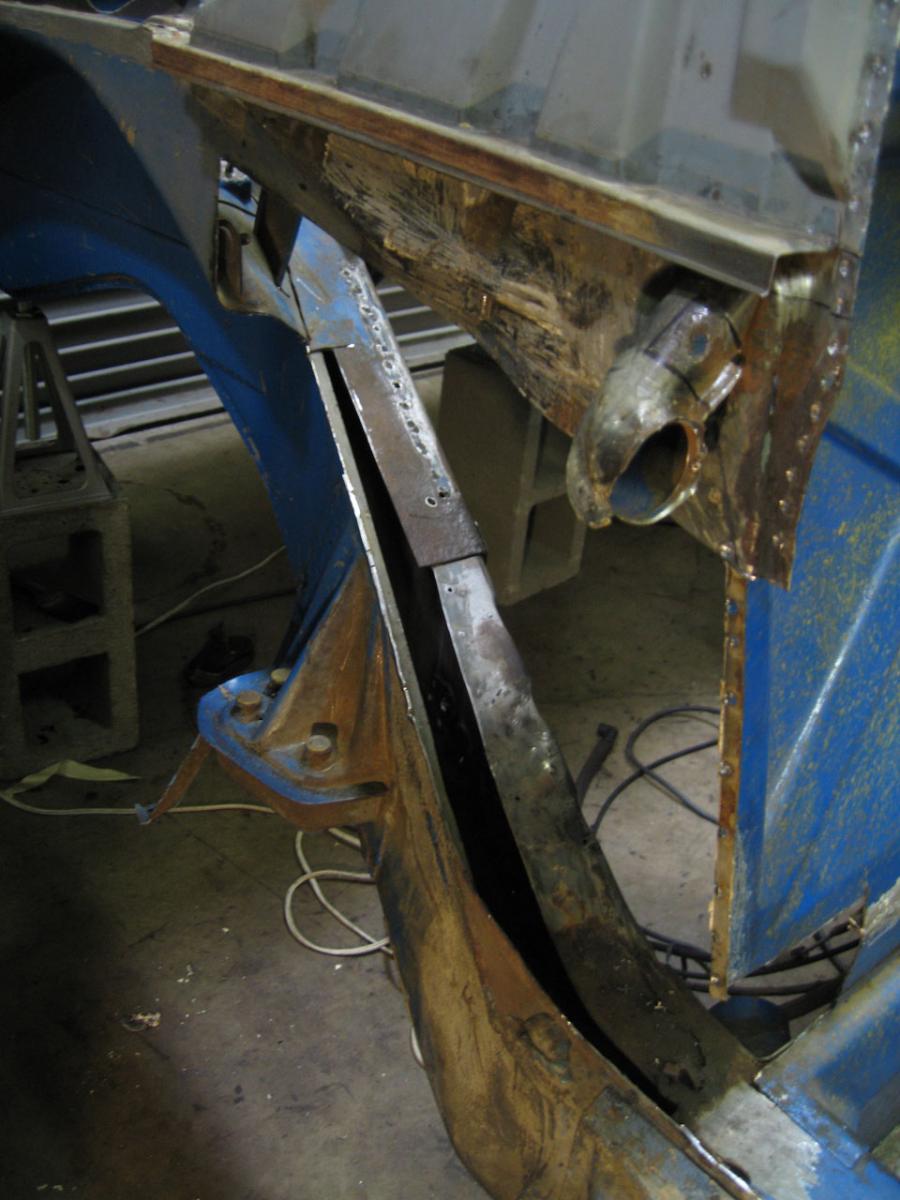

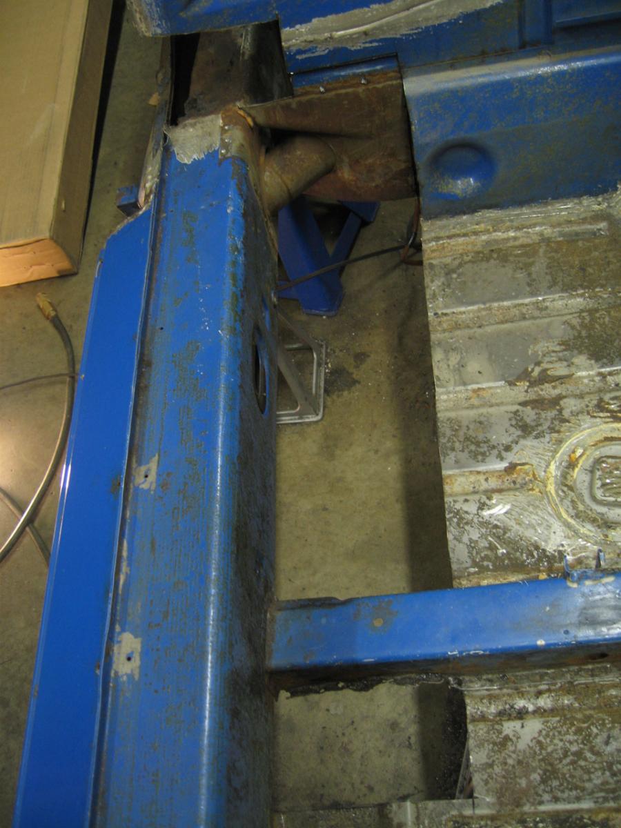

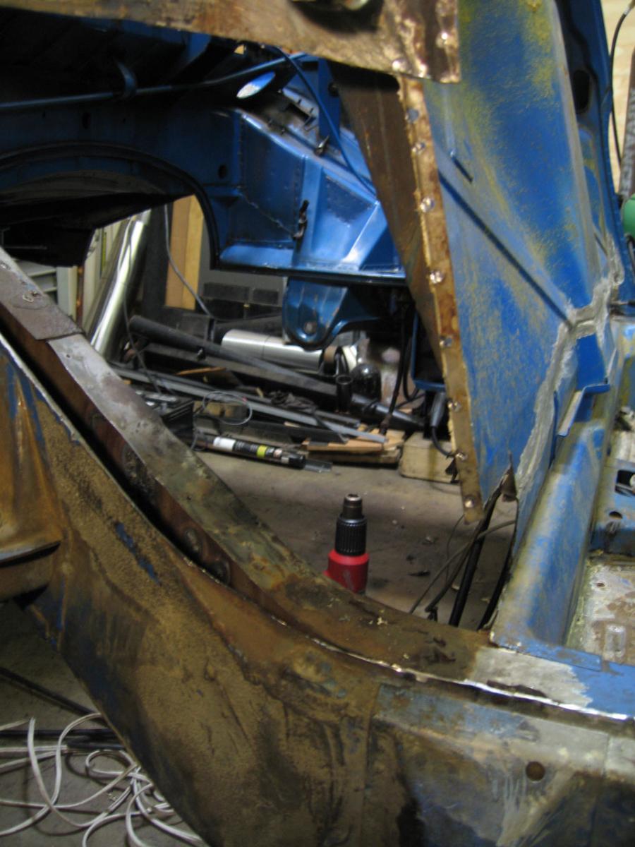

The struggle to envision the completion of the hell hole repair is ... also coming along. (IMG:style_emoticons/default/unsure.gif)
(IMG:http://www.914world.com/bbs2/uploads_offsite/www.914club.com-11782-1292380343.5.jpg)
(IMG:http://www.914world.com/bbs2/uploads_offsite/www.914club.com-11782-1292380343.6.jpg)
(IMG:http://www.914world.com/bbs2/uploads_offsite/www.914club.com-11782-1292380344.7.jpg)
An unconventional approach undoubtedly. I want to take the floor pan off but I have to wait until the long and fender are together before that happens, and it still seems like a challenge to support it even then.
For now the plan is to take out the entire inner long, heater tube with it. I'm mustering my strength, waiting for more jack stands to arrive before I dive in. (IMG:style_emoticons/default/smash.gif)

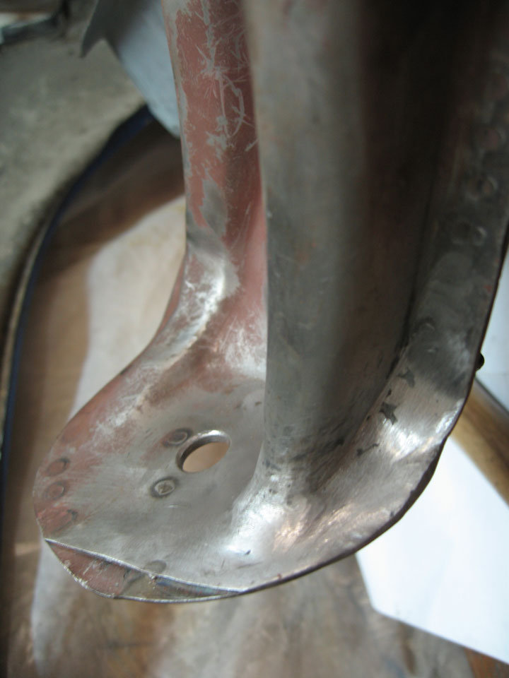

Replacement panel sculpture
(IMG:http://www.914world.com/bbs2/uploads_offsite/www.914club.com-11782-1292380344.8.jpg)

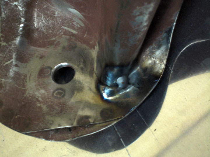

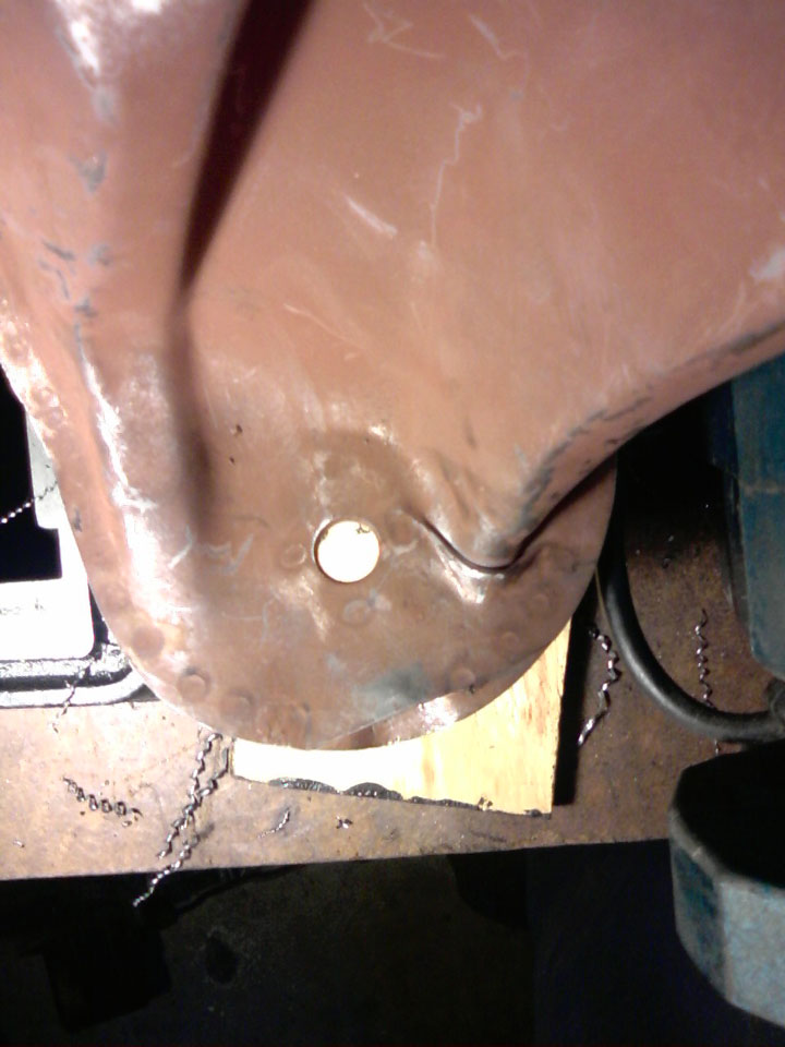

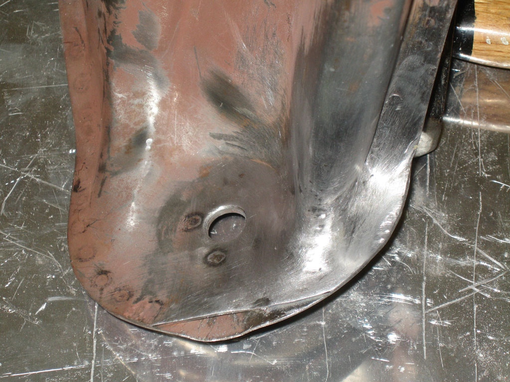

and my suspension ear wrinkle fix
(IMG:http://www.914world.com/bbs2/uploads_offsite/www.914club.com-11782-1292380344.9.jpg)
(IMG:http://www.914world.com/bbs2/uploads_offsite/www.914club.com-11782-1292380345.10.jpg)
(IMG:http://www.914world.com/bbs2/uploads_offsite/www.914club.com-11782-1292380345.11.jpg)
(IMG:http://www.914world.com/bbs2/uploads_offsite/www.914club.com-11782-1292380345.12.jpg)
Inside
(IMG:http://www.914world.com/bbs2/uploads_offsite/www.914club.com-11782-1292380345.13.jpg)
I' think I will smooth the welds in there a bit , as it is a drain passage there. Access could be better but do-able.

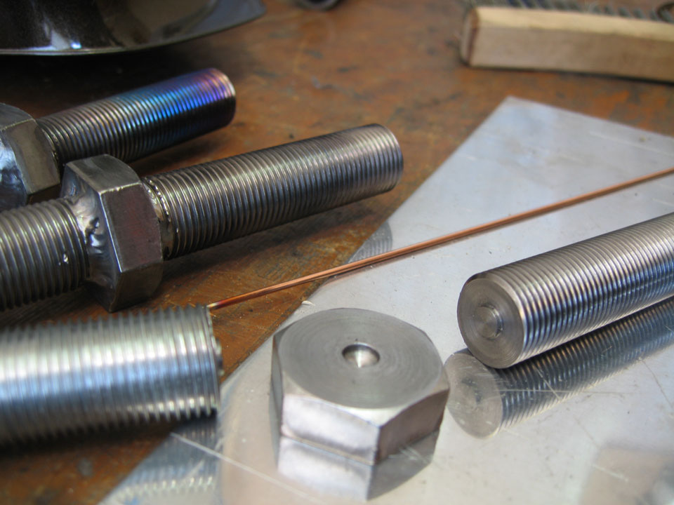

nathansnathan   I've finished enhancing my engine stand and th...   May 30 2011, 09:38 AM
