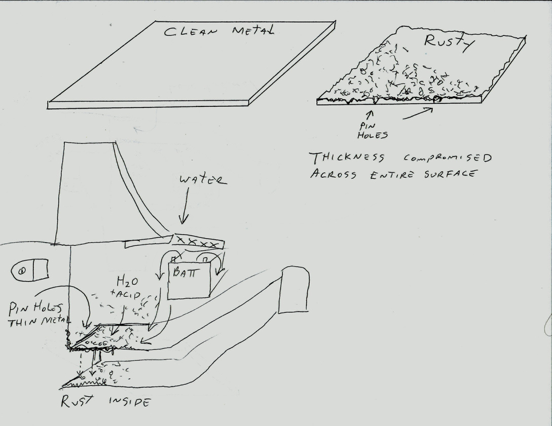

...and the vertical wall (inner wheel house)behind the battery is a sheer panel. it helps keep the chassis box section (longitudinal) from flexing. while the vertical sides of the long keep things staight, the top and bottom of the long carry the load of flex in teh vertical plane. think I beam

sean_v8_914   snap a photo of the seam under teh hell hole. the ...   Dec 16 2010, 08:25 AM

sean_v8_914   thank you. that view shows the two different layer...   Dec 19 2010, 08:38 AM

sean_v8_914   compared to others, this chassis is fairly solid. ...   Jan 22 2011, 11:02 AM
sean_v8_914   the rust seems to weaken the spot welds. then they...   Jan 22 2011, 11:09 AM
