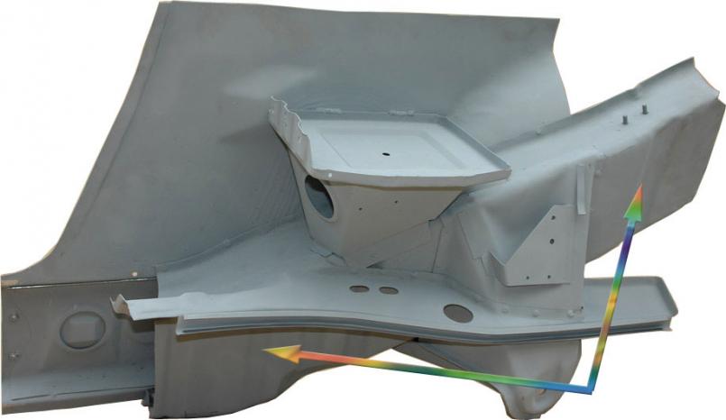

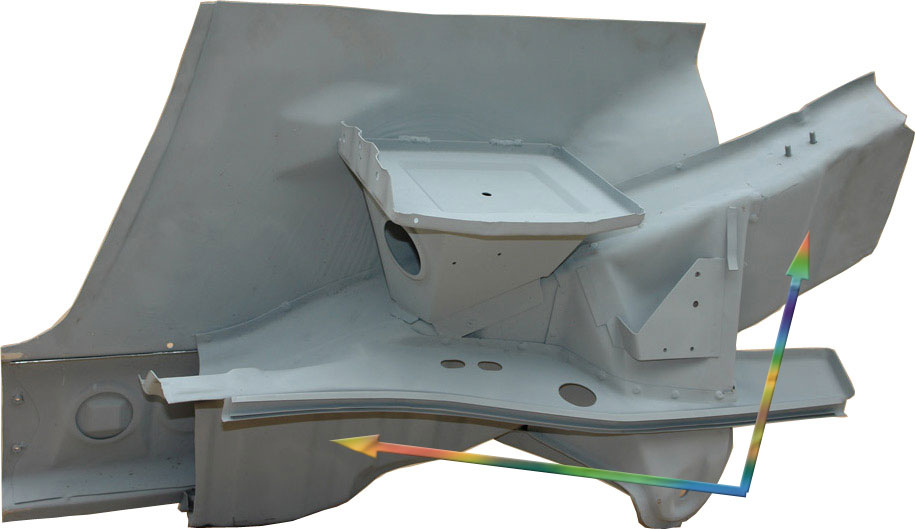

sean_v8_914   snap a photo of the seam under teh hell hole. the ...   Dec 16 2010, 08:25 AM
karlo   Got a better picture of the underside of the LHS l...   Dec 16 2010, 01:28 PM
sean_v8_914   viva la plasma cutter   Dec 16 2010, 10:56 PM
karlo   Sounds like I need to pay you a visit. :) Need to...   Dec 16 2010, 11:36 PM
sean_v8_914   it is MUCH better to do the chassis work while the...   Dec 17 2010, 08:31 AM
sean_v8_914   exp   Dec 17 2010, 08:34 AM
sean_v8_914   I like this one too but doesnt show area of discus...   Dec 17 2010, 08:36 AM
sean_v8_914   since we are talking about messed up chassis...cen...   Dec 17 2010, 08:37 AM
roadster fan   This is not the best pic but may be helpful Jim   Dec 18 2010, 05:13 PM
karlo   This is not the best pic but may be helpful Ji...   Dec 18 2010, 07:07 PM
sean_v8_914   thank you. that view shows the two different layer...   Dec 19 2010, 08:38 AM
