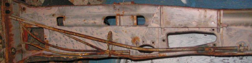

since we are talking about messed up chassis...center tunel pic is good to have
