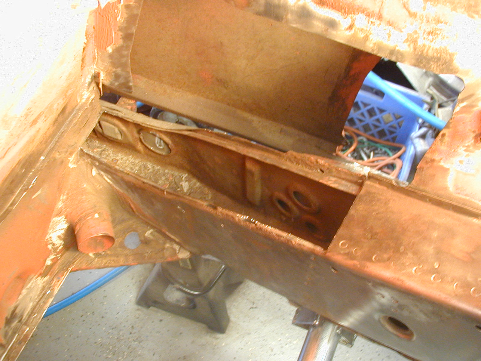

This is not the best pic but may be helpful
Jim

Thanks for the illustrations, guys. I will have Sean cut open the long to see what needs to be done. This is something I want to get sorted out as soon as possible.
