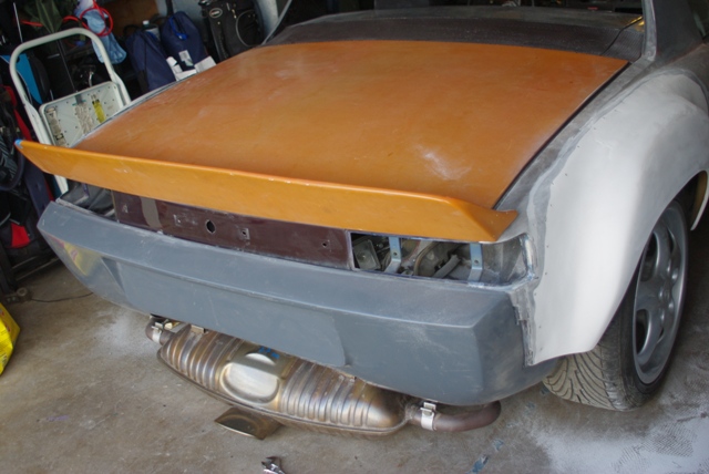

raw1298   Started on rear bumper today. Two step process. Fi...   Apr 7 2016, 03:15 PM
raw1298   A little filler....   Apr 7 2016, 03:18 PM
raw1298   Few rough patches, but not bad for a rookie like m...   Apr 7 2016, 03:48 PM
raw1298   Ran somE 40 grit over it to smooth out. I have som...   Apr 7 2016, 04:14 PM
raw1298   Side view.   Apr 7 2016, 04:21 PM
raw1298   I am really liking the way this is heading. Time f...   Apr 7 2016, 04:35 PM
raw1298   One more. :D   Apr 7 2016, 04:40 PM

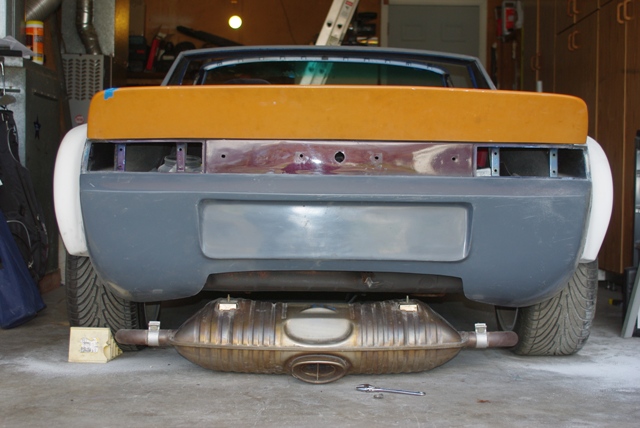

raw1298   Starting to get close.   Apr 17 2017, 05:05 PM
raw1298   Side view   Apr 17 2017, 05:07 PM
ConeDodger   Fantastic progress Randy! :headbanger:   Apr 17 2017, 05:18 PM
raw1298   Thanks Rob. Life is getting simpler, more time to ...   Apr 17 2017, 05:41 PM
raw1298   Starting to get real close.   Apr 18 2017, 05:00 PM
raw1298   Other side   Apr 18 2017, 05:02 PM
