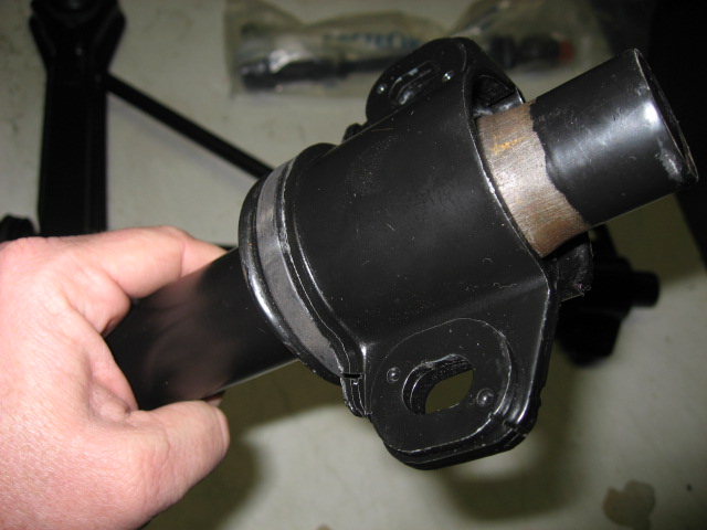

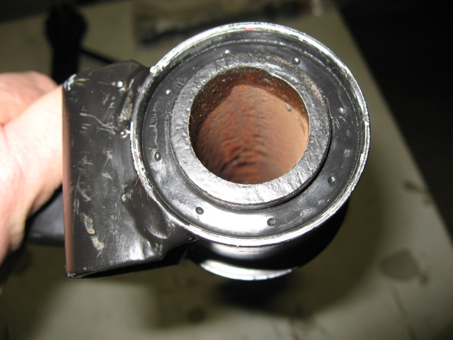

ive searched and cant find any feed back on these (other then 2 less then favorable reviews on the bird site)
the price is right but is it worth the hassle? mine are pretty mushroomed so i think anything is better then what ive got...but i am on a budget (IMG:style_emoticons/default/sad.gif)
any feed back on these would be great (IMG:style_emoticons/default/beerchug.gif) Dave

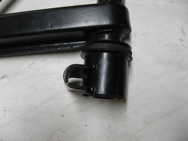

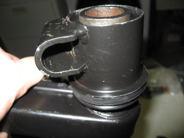

silver74insocal   well i have had these URO bushings in for about a ...   Feb 21 2011, 12:09 AM

rdauenhauer   In replacing the Fronts, the OE Rubber bushings we...   Feb 21 2011, 02:52 PM
