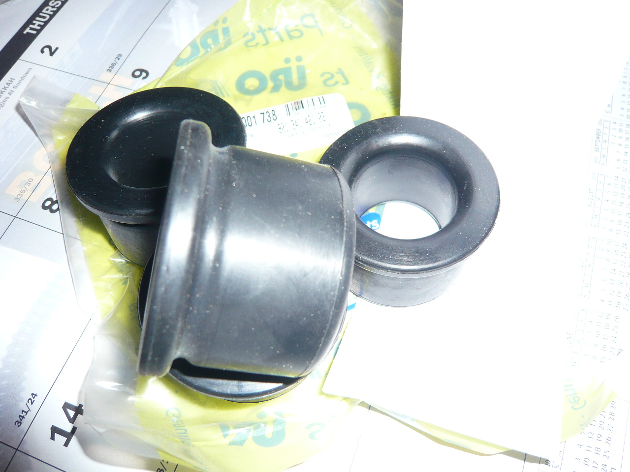

well i have had these URO bushings in for about a month so i thought i would update this.
these went in almost effortlessly, as long as you heat them right up to the minute you are going to put them on.
we used the bottom of the scissor lift with the car on it, and a floor jack by putting the a arm between the 2 and pushing up with the jack.
before the install, we went to lowes and purchased some PVC adapters, one size larger then the bushing, and one equal to the size of the bushing (thanks to a member named WesV for that idea) . when installing, we alternated between the 2. we started with the larger size and when the bushing hung and started to roll out, we switched to the smaller diameter pvc coupler to push the bushing itself. SOAP IS YOUR FRIEND smile.gif
theres more info if you see my other thread :socal teeners front end rebuild party

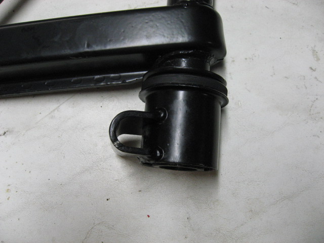

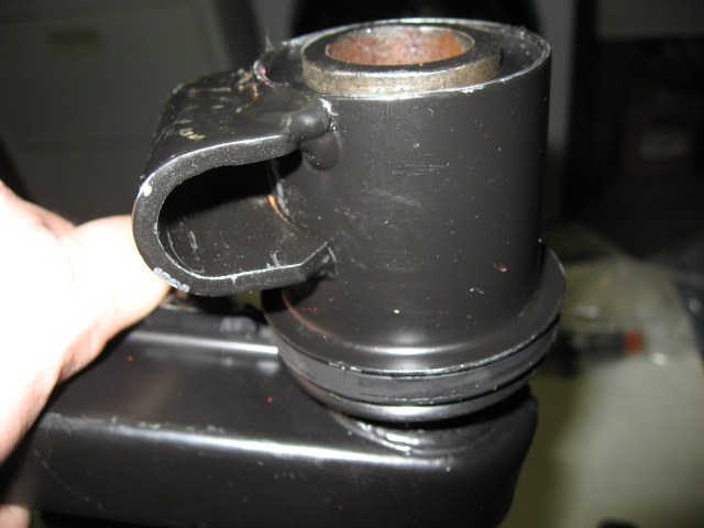

914werke
In replacing the Fronts, the OE Rubber bushings were installed *clocked* so that the arm was positioned at a certain (downward) angle once mounted.
Once installed the Rubber options presumably dont SLIP but twist slightly.
Are you guys having installed these taking care to restore that angle?
I dont recall this detail being addressed on that URO video clip..
kconway
I used the ER version, and the instructions/video were quite clear on this point. That said, I clocked them the wrong way and had to remove and reinstall. Not a job you want to do twice as it was a PIA without the help of a lift, jack or press.
Hopefully the URO parts come with the same instructions...
