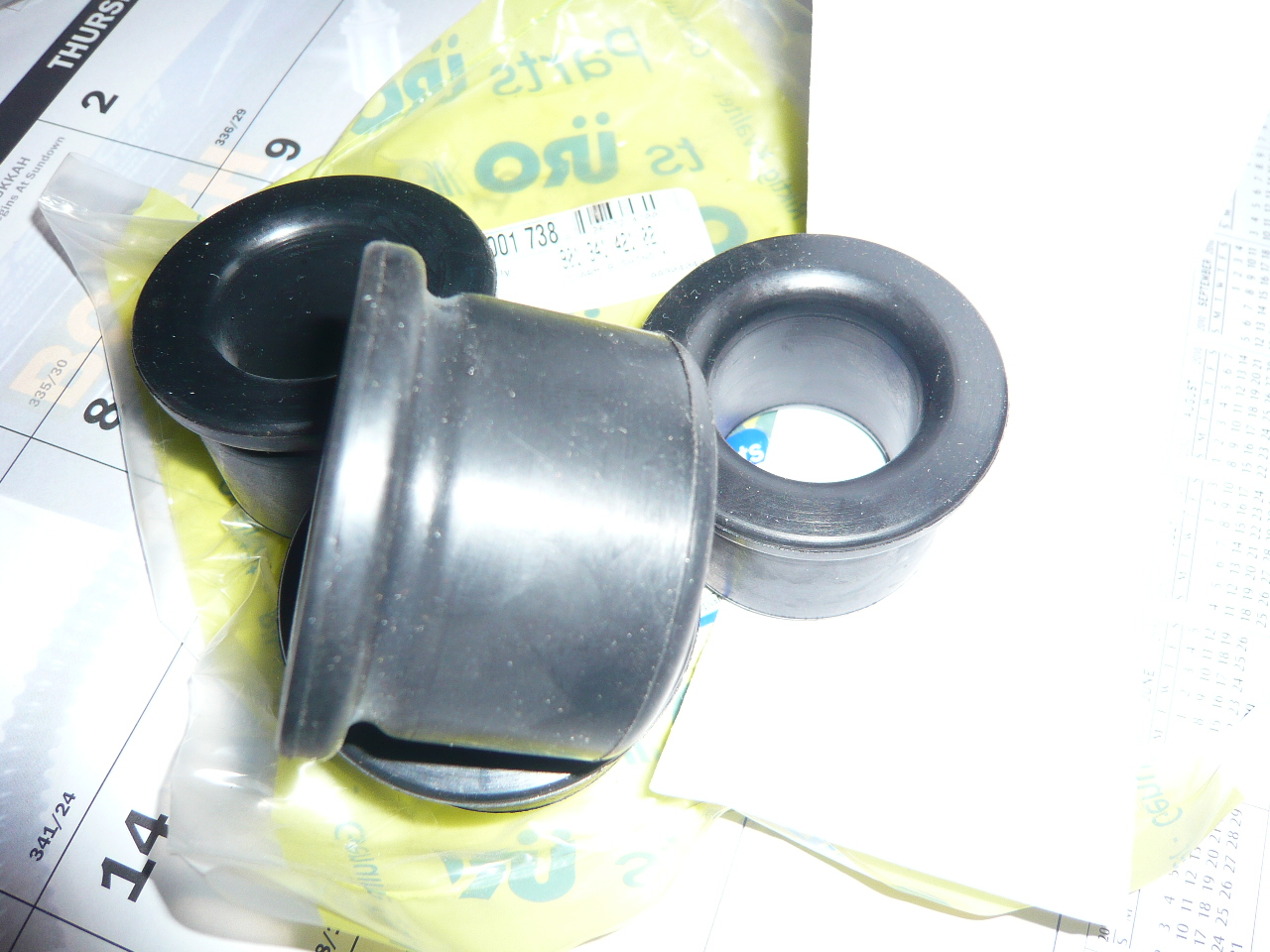

> front a arm bushings, update: URO bushings installed thanks PMB
silver74insocal
post Dec 29 2010, 10:30 PM
Posts: 736
Joined: 26-November 09
From: rancho cucamonga
Member No.: 11,073
ive searched and cant find any feed back on these (other then 2 less then favorable reviews on the bird site)
the price is right but is it worth the hassle? mine are pretty mushroomed so i think anything is better then what ive got...but i am on a budget (IMG:style_emoticons/default/sad.gif)
any feed back on these would be great (IMG:style_emoticons/default/beerchug.gif) Dave

However, is there a method for determining just how bad the bushings might be with removing the suspension?
You can measure them... top and bottom. Check the difference.

"I went from stock old worn out bushings to two sets of plastic bushings...plastic just sucks. I went through two sets.
Yes they were not the special compound...
All that means is they will last longer.
They still squeak." quoted form Towle
