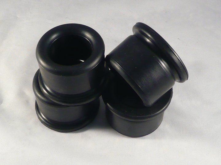

ive searched and cant find any feed back on these (other then 2 less then favorable reviews on the bird site)
the price is right but is it worth the hassle? mine are pretty mushroomed so i think anything is better then what ive got...but i am on a budget (IMG:style_emoticons/default/sad.gif)
any feed back on these would be great (IMG:style_emoticons/default/beerchug.gif) Dave

I'm growing weary of group buys but I put a post in the "Member Vendor" section on these:
(IMG:http://www.914world.com/bbs2/uploads_offsite/sphotos.ak.fbcdn.net-1110-1293817307.1.jpg)
http://www.914world.com/bbs2/index.php?showtopic=114245
Special pricing for the next week. I'll place an order Monday 1/10 and should ship 1/14.
