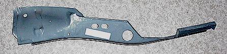

On further inspection of your pic, where is the engine shelf piece I mentioned, it is missing...battery tray? That piece missing would included the hole area as well but as 74 So Cal stated... the piece will but up to your longitudinal which seems to be fine or very slightly rusted at the edge hole area/engine shelf, still not a bad situation at all..
The rep[lacement piece for that area is pictured below so you can get an Idea what is affected on yur car or not..
