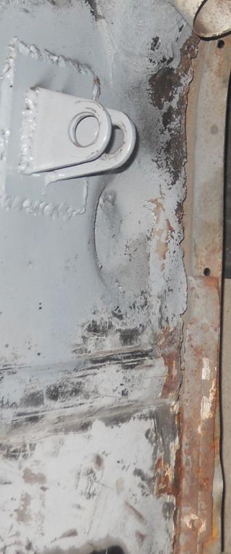

I'm a 914 newbie, but not a 911 newb. I was going to buy this car for a race car project. I showed the pictures to a fellow 914 racer and he had some concerns about the Hell Hole area. I figured I could just weld over the spot to strengthen, but from what I understand it could be more than just the hole that shows damage.
So after doing some more research, I'm even more concerned.
I asked the seller to send me more pictures of this area from the top, bottom, and from the wheel well area.
Just looking for some more guidance, should I pass on it and look for a different car? I'm thinking it may not be worth the headache. Your thoughts?

QUOTE(J P Stein @ Jan 1 2011, 12:32 PM) *
Right below the clevis on the firewall
I think this is what you are looking for..... And I think I see what you mean....

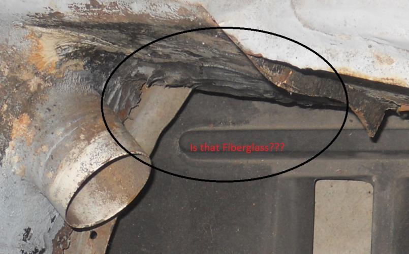

Is that fiberglass on the other picture?

JRust   Really depends how bad it is below that. that is t...   Jan 1 2011, 01:53 PM
detoxcowboy   Really depends how bad it is below that. that is ...   Jan 1 2011, 01:56 PM
detoxcowboy   On further inspection of your pic, where is the en...   Jan 1 2011, 01:54 PM
C.Plavan   Here is a better close up picture. The car wa...   Jan 1 2011, 02:00 PM
JRust   the lower area circled i am not sure of. Looks lik...   Jan 1 2011, 02:18 PM

J P Stein   That alone is not a show stopper.....IF the of the...   Jan 1 2011, 02:06 PM

J P Stein   Blow up your first pic and look at the edge of the...   Jan 1 2011, 02:27 PM
J P Stein   Right below the clevis on the firewall   Jan 1 2011, 02:32 PM
C.Plavan   Right below the clevis on the firewall I think...   Jan 1 2011, 02:51 PM
J P Stein   There is a piece missing there, the doughnut brack...   Jan 1 2011, 02:58 PM
