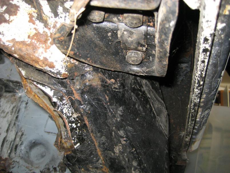

I'm a 914 newbie, but not a 911 newb. I was going to buy this car for a race car project. I showed the pictures to a fellow 914 racer and he had some concerns about the Hell Hole area. I figured I could just weld over the spot to strengthen, but from what I understand it could be more than just the hole that shows damage.
So after doing some more research, I'm even more concerned.
I asked the seller to send me more pictures of this area from the top, bottom, and from the wheel well area.
Just looking for some more guidance, should I pass on it and look for a different car? I'm thinking it may not be worth the headache. Your thoughts?

silver74insocal   :wttc: more experienced people will chime in soon...   Jan 1 2011, 01:45 PM
MrHyde   You California peoples get all the good cars ...   Jan 1 2011, 01:45 PM
detoxcowboy   California Car? How was it stored? Empty lot? Or a...   Jan 1 2011, 01:46 PM
JRust   Really depends how bad it is below that. that is t...   Jan 1 2011, 01:53 PM
detoxcowboy   Really depends how bad it is below that. that is ...   Jan 1 2011, 01:56 PM
detoxcowboy   On further inspection of your pic, where is the en...   Jan 1 2011, 01:54 PM
C.Plavan   Here is a better close up picture. The car wa...   Jan 1 2011, 02:00 PM
JRust   the lower area circled i am not sure of. Looks lik...   Jan 1 2011, 02:18 PM
dr914@autoatlanta.com   That damage is nothing! If the car is cheap e...   Jan 1 2011, 02:03 PM
J P Stein   That alone is not a show stopper.....IF the of the...   Jan 1 2011, 02:06 PM
detoxcowboy   DR. Auto Atlanta can provide all the replacement p...   Jan 1 2011, 02:06 PM
C.Plavan   It has new floor pans, but notice the cut and weld...   Jan 1 2011, 02:14 PM
J P Stein   Blow up your first pic and look at the edge of the...   Jan 1 2011, 02:27 PM
J P Stein   Right below the clevis on the firewall   Jan 1 2011, 02:32 PM
C.Plavan   Right below the clevis on the firewall I think...   Jan 1 2011, 02:51 PM
J P Stein   There is a piece missing there, the doughnut brack...   Jan 1 2011, 02:58 PM

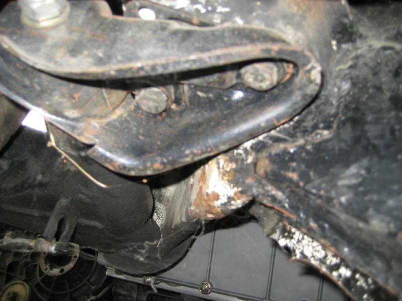

C.Plavan   More pictures. Owner says he did a screwdriver te...   Jan 1 2011, 04:55 PM
C.Plavan   more pictures   Jan 1 2011, 04:57 PM
C.Plavan   more   Jan 1 2011, 04:59 PM
C.Plavan   Rockers look a little different.   Jan 1 2011, 05:02 PM
Spoke   This car looks like an east coast rust bucket. The...   Jan 1 2011, 05:08 PM
kg6dxn   Based on the last pictures... Buy a new tub and st...   Jan 1 2011, 05:10 PM
brant   Chad, good to see you on this board and looking ...   Jan 1 2011, 05:19 PM
Joe Sharp   Post #21 :woohoo: :angry: It looks to me like tha...   Jan 1 2011, 05:20 PM
C.Plavan   This car looks like an east coast rust bucket. Th...   Jan 1 2011, 05:35 PM
Racer Chris   I would want to see pictures of the existing repai...   Jan 1 2011, 07:28 PM
SirAndy   More than likely, those pictures would convince me...   Jan 1 2011, 11:18 PM
J P Stein   :agree:   Jan 1 2011, 07:35 PM
MrHyde   Those last pics look like what was done to my car ...   Jan 1 2011, 10:59 PM
hot_shoe914   Well, since nobody else asked, I will. Does that m...   Jan 1 2011, 11:57 PM
Racer Chris   Well, since nobody else asked, I will. Does that ...   Jan 2 2011, 06:12 AM
C.Plavan   That was a 911 2.2L he had it in there to mock up ...   Jan 2 2011, 10:01 AM
detoxcowboy   :blink: This thread started with a small hole.... ...   Jan 2 2011, 10:01 AM
J P Stein   That's one nice 9eleben. :D As for a parts ca...   Jan 2 2011, 10:30 AM
C.Plavan   That's one nice 9eleben. :D As for a parts c...   Jan 2 2011, 12:05 PM
J P Stein   Thanks- I love that Blue monster. Would it chan...   Jan 2 2011, 12:44 PM
kg6dxn   Buy it for parts. cut the cage out carefully and r...   Jan 2 2011, 12:18 PM
C.Plavan   Earlier, I was more concerned with that rust hole,...   Jan 2 2011, 01:03 PM
Racer Chris   Earlier, I was more concerned with that rust hole...   Jan 2 2011, 03:38 PM
jeeperjohn56   Hey Chad, Check with Craig(Boxstr) in the car want...   Jan 2 2011, 06:11 PM
realred914   that body should be run away from, too much rust t...   Jan 3 2011, 01:41 AM
