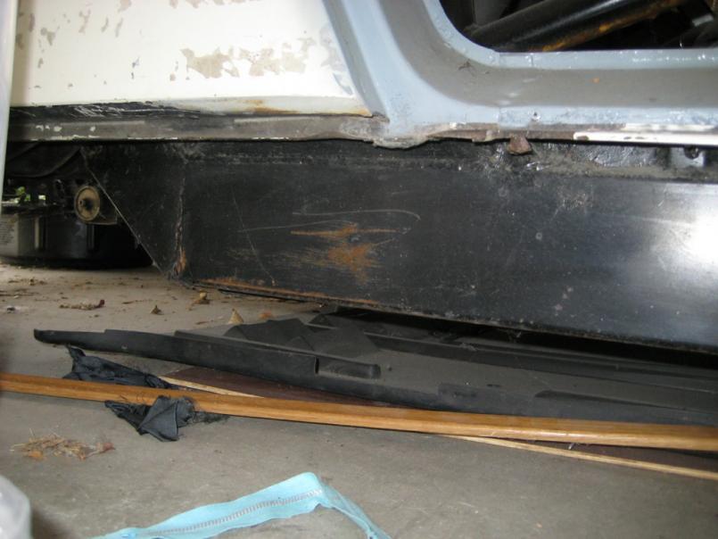

Rockers look a little different.

Spoke   This car looks like an east coast rust bucket. The...   Jan 1 2011, 05:08 PM
kg6dxn   Based on the last pictures... Buy a new tub and st...   Jan 1 2011, 05:10 PM
brant   Chad, good to see you on this board and looking ...   Jan 1 2011, 05:19 PM
Joe Sharp   Post #21 :woohoo: :angry: It looks to me like tha...   Jan 1 2011, 05:20 PM
C.Plavan   This car looks like an east coast rust bucket. Th...   Jan 1 2011, 05:35 PM
