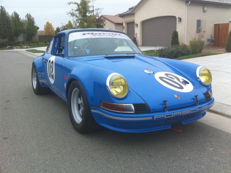

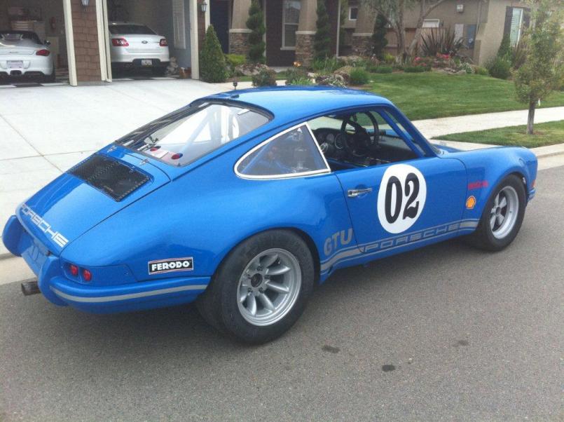

To bring a little happiness to this thread, here is my 911ST race car that I just completed a makeover on. With English Wheel rear steel flares done locally.
