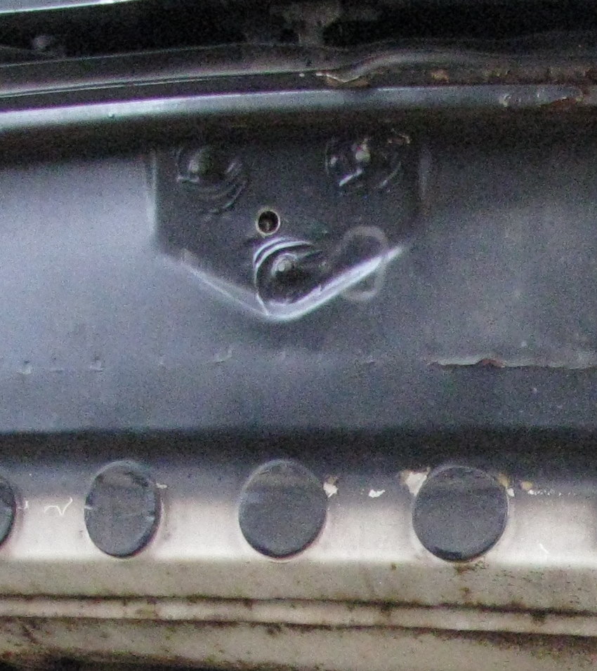

(IMG:style_emoticons/default/sad.gif)
so it there an easy way to do this without major surgery?

For future reference Dan, the small hole dead center of the front panel in the pic of my 73 below gives you access with a flat-head screwdriver to pop the emergency release pin on the lower latch mechanism inside (once you get the bumper off) & is there on all MYs.
