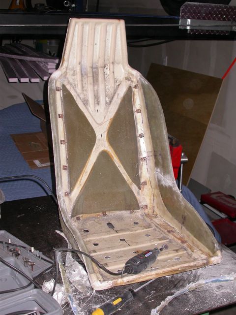

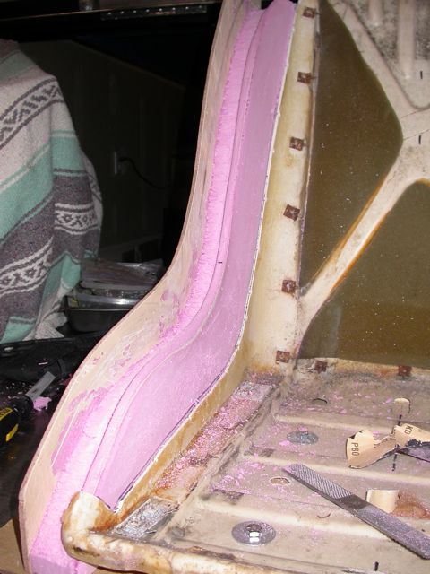

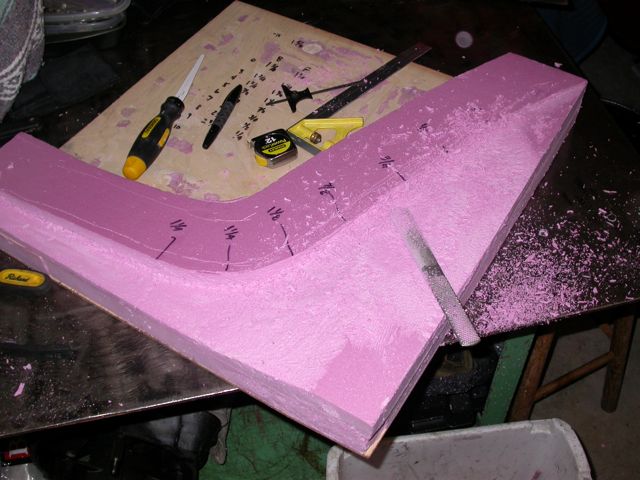

Use the pink stuff from Home Depot. You can rough the shape in with a course wood file, then finish sand to shape w/ 80 grit sandpaper. But, you need to cover it with something before laying fiberglass over it, the resin will melt the foam.
I just used it over the holiday to make a mold for my "GT" seat project. Worked great and now I have two 914 seat shells w/ extended bolsters. (IMG:style_emoticons/default/cheer.gif) Next step is to learn how to do upholstery.
