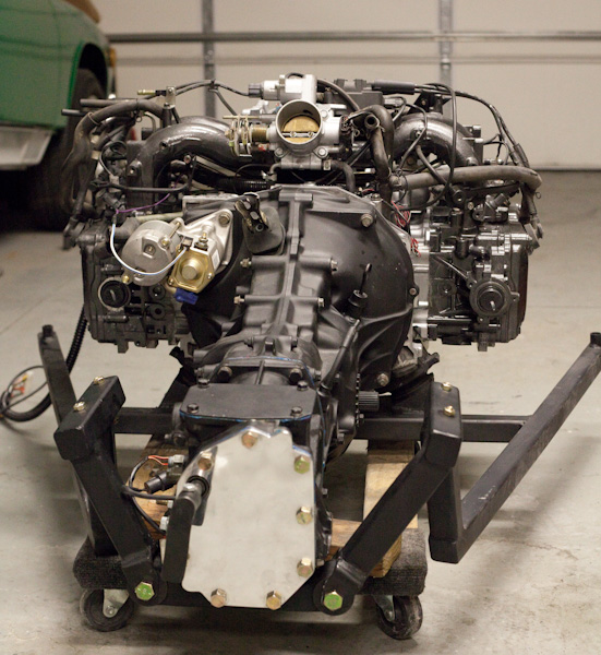

Made some more progress...
- Refinished fuel tank internals with eastwood kit.
- Stainless fuel lines and walbro fuel pump installed
- 2wd conversion spool and cover plate finished
- act 12lb flywheel
- exedy stage 1 clutch
- shortened trans dipstick for clearance
- spent a bunch of time cleaning up motor and trans. New soda blaster worked wonders on getting the corrosion off all the sand casted aluminum.
- Ready to go back in the car and finish connecting up the wiring harness. Hope to fire it up this weekend.
