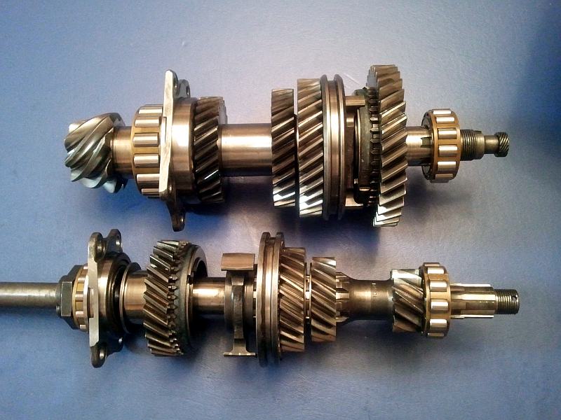

I've been shopping for new gears, synchronizers, dogteeth and sliders for the 915 transmission. Preliminary assembly of the gear stacks looks like this (haven't pressed everything in place yet):
Looks like I might have a transmission yet.
The ring and pinion has fortunately not suffered any damage. The input shaft measures .0045" runout. Stepped by Wholesale Automotive Machine here in San Diego, but they thought they would only make things worse by attempting to straighten it, and opined that it should be too little to matter. Apparently, .003" is the permissible runout. Any suggestions for how to proceed?
