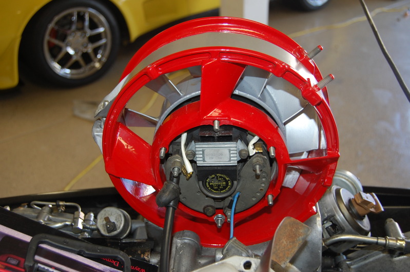

I need help afterall. Here is my alternator. Do I have it mounted correctly. I assumed it belonged with the print right side up and regulator up. Correct???

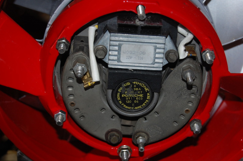

Next, I'm hooking up Perry's beautiful wire harness to the alternator. It came with a slim blue wire, and a fat black wire. I did not take the alternator out, so I have no pictures of before. Do I have it right?????

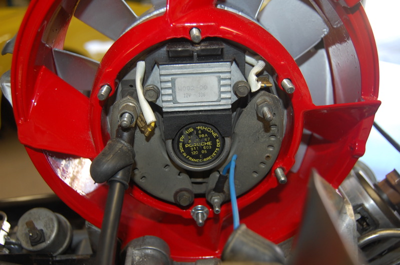

Also, I don't have the alternator to ground strap, but I can build one easily. Where does it hook up?

sixnotfour   check your belt alignment , you may have a mismatc...   Jan 8 2011, 07:20 PM
Bee Jay   The voltage regulator needed to be inverted and I ...   Jan 11 2011, 12:53 AM
