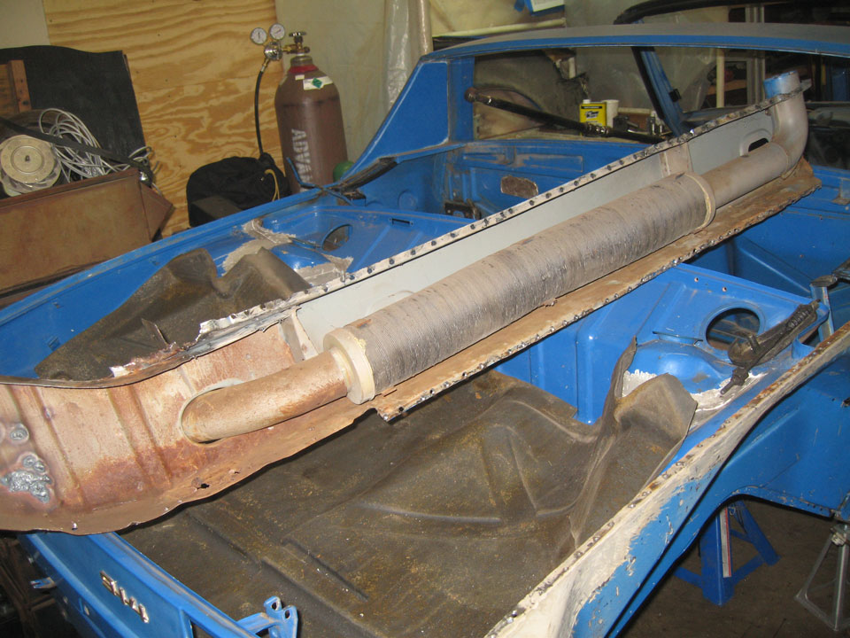

I want to keep the thread updated.
I went on vacation, up to the bay for about a week over Christmas.

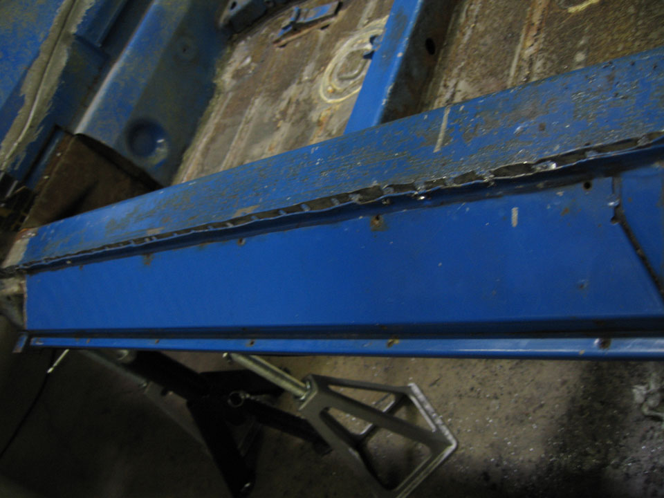

Contemplating removal of the passenger inner long in its entirety without removal of the outer the whole time...

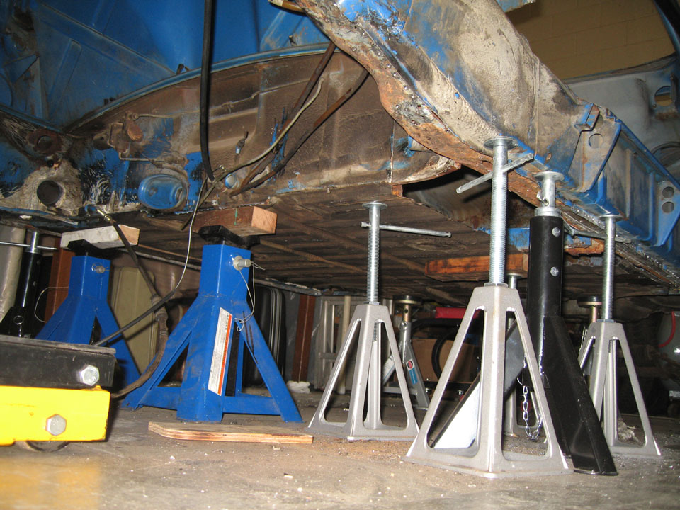

I'd got these additional jack stands for the inner long removal. It seems to me that you can only really have 4 jack stands actually holding up a car safely, unless additioanl ones are the leveling type. I found the black ones online. I trust them over the little aluminum ones to be sure.
(IMG:http://www.914world.com/bbs2/uploads_offsite/www.914club.com-11782-1294592744.1.jpg)

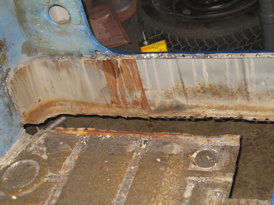

The task at hand, it took me 2 days after work drilling out spot welds, the upper

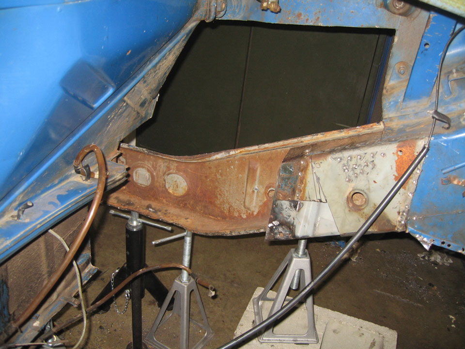

and lower, many many spot welds
(IMG:http://www.914world.com/bbs2/uploads_offsite/www.914club.com-11782-1294592745.3.jpg)
I took my time with it. It's single layer just in front of the lower p seatbelt mount bolt forward to where the front door frame swoops up. Tricky to separate the layers there. I thought of nicknaming the car The Blue Onion... for some reason.

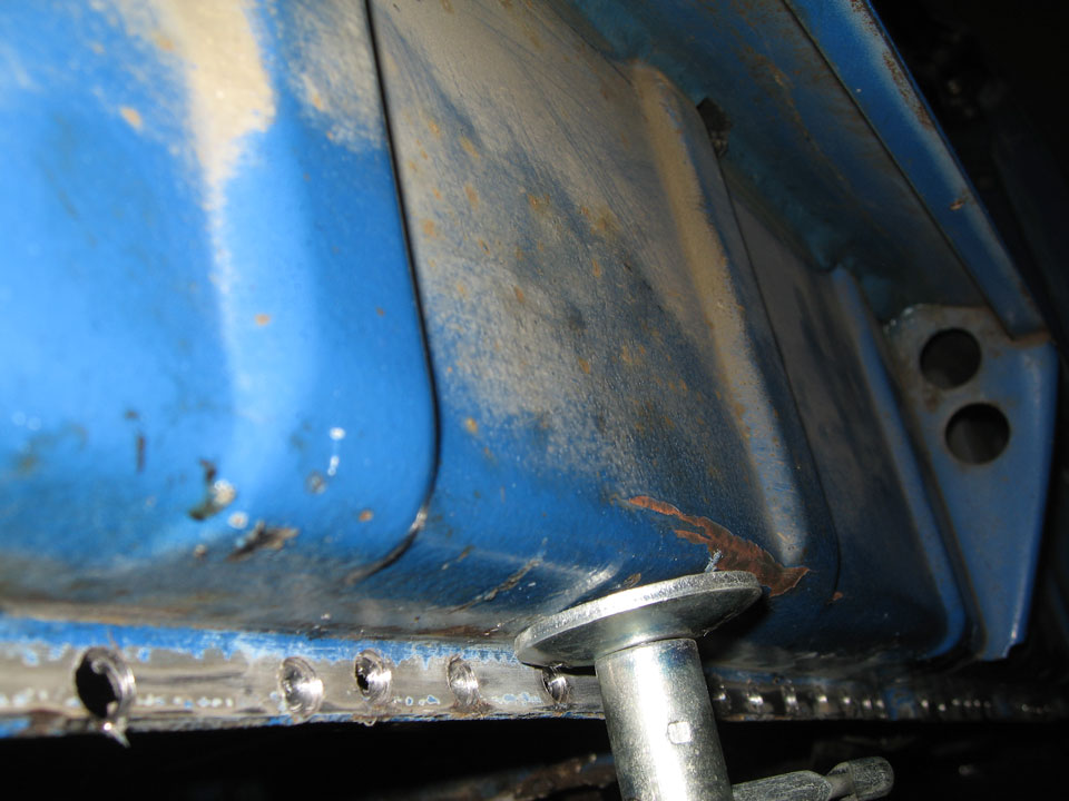

More, grinding at the mig welds that hold it to the front firewall/ rear of the passenger wheel well - complicated by the heater tube at the front being in the way of 1 particularly ( had to do some cuttin' on account of that)
(IMG:http://www.914world.com/bbs2/uploads_offsite/www.914club.com-11782-1294592745.4.jpg)

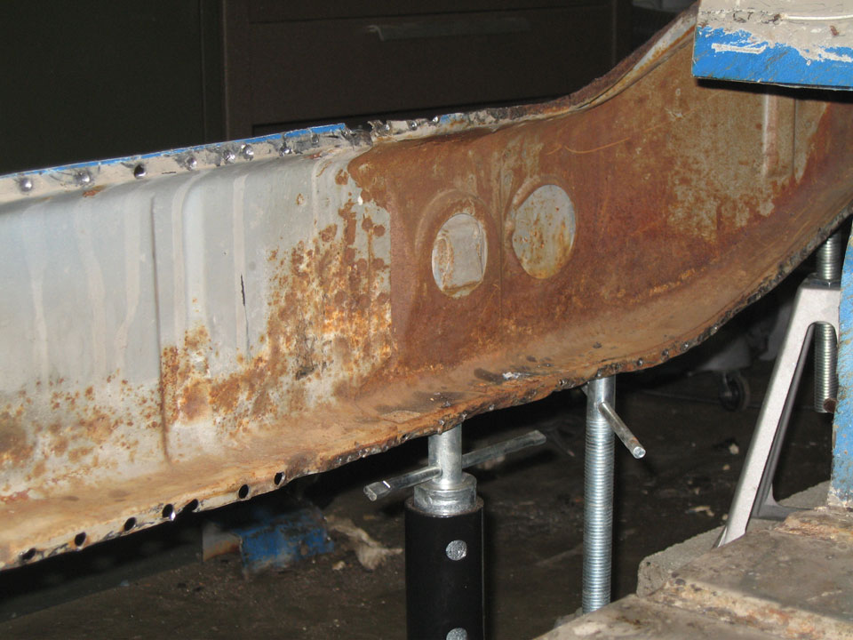

You can see where I tried to weld up some damage to the inner inner long there with all that rust. I guess just practice or wishful thinking that was...
(IMG:http://www.914world.com/bbs2/uploads_offsite/www.914club.com-11782-1294592746.5.jpg)
(IMG:http://www.914world.com/bbs2/uploads_offsite/www.914club.com-11782-1294592747.6.jpg)
now that's a hell hole
