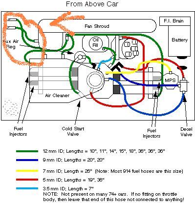

Below is the fuel evaporation lines at the engine compartment TOM was ititerating..
They come in behind and below the relay board from your charcoal cannister via the drivers side rocker panel, and there are cloth hose connections in the drivers front wheel well by the antenna and in the rocker panel that are made of cloth covver hose.. Usaally hard as a rock by now, unless you have replaced them..
The rest are vac hoses..
