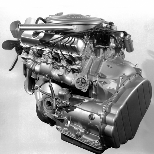

The "Unitized Power Package" (UPP) was used in first, second and third generation Toronados (1966-1985) and was a longitudinal arrangement. The "sideways" mounted drive trains did not appear until the 1986 model

Jacob   The "Unitized Power Package" (UPP) was u...   Jan 9 2011, 08:44 PM
jaxdream   The "Unitized Power Package" (UPP) was ...   Jan 10 2011, 07:59 AM
