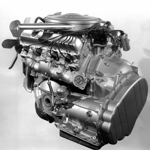

The "Unitized Power Package" (UPP) was used in first, second and third generation Toronados (1966-1985) and was a longitudinal arrangement. The "sideways" mounted drive trains did not appear until the 1986 model

QUOTE(Jacob @ Jan 9 2011, 06:44 PM)
Click to view attachmentYep , and they weigh around 385 LBS with tourque converter , axles , no fluid. I got one years ago , weighed on the scales at where I worked , they be HEAVY !!
