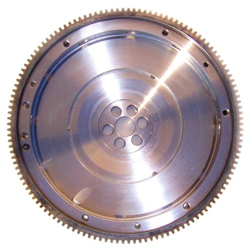

Hi All –
I am in the final throws of my conversion. At this point the tub is done and everything is bolt on. The only part that is not easily accessible/changeable without big headaches is the flywheel/clutch, so I want to make sure I don’t bugger this up. Attached is a picture of a flywheel that I located on another web board. I was told it is original, worked fine, and was only removed because of a motor upgrade. The last clutch I personally replaced was in my 1985 GTI, so my knowledge is limited to say the least (the VERY least!!). Can any of you tell by this picture if this looks okay? I would have it machined prior to install, is there a minimum thickness I should ask the seller to verify? Thanks a ton – Scott S Attached image(s)

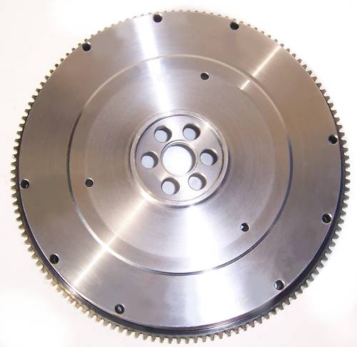

Does anyone have any experience dealing with a manufacturer called "QSC"? I googled them and didn't find anything crazy negative about them. Jake was doing a review on their products a few years back, but that was the end of the thread - no final results. Here is a picture.... Attached image(s)

Jeffs9146 Need close-up of the surface! Are there cracks... Jan 11 2011, 10:58 AM
realred914 cant tell in detail, but maybe just scuff up the r... Jan 11 2011, 11:15 AM
zymurgist I would want to see the surface that rides against... Jan 11 2011, 11:17 AM
9146986 Hard to tell from the pics, it looks flat, which i... Jan 11 2011, 11:58 AM
underthetire Ya, it's missing a ring gear ! Jan 11 2011, 12:01 PM
Scott Schroeder
Holy cra... Jan 11 2011, 12:13 PM
KELTY360
Holy cr... Jan 11 2011, 12:16 PM
SLITS That is nothing but the flywheel off a '70 ... Jan 11 2011, 12:38 PM
SLITS You should be able to find an early 901, used, for... Jan 11 2011, 01:27 PM
sixnotfour I have a good 901 6bolt lightened to 9-10 lbs, goo... Jan 11 2011, 04:07 PM
SLITS
I have a good 901 6bolt lightened to 9-10 lbs, go... Jan 11 2011, 06:40 PM
