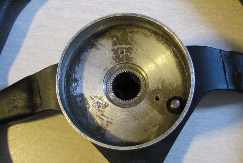

Changing steering wheel and new mom adapter will not slide on far enough...Slides over serrated shaft but stops 1 to 2 inches short. Can't tell what is up...Experience here ??? For a1974 ....bought new part
Thanks . Wheel hit as shaft gets larger after serrations . Lost but been that kind of weekend ! Terry |

sixaddict Help /new momo adapter does fit Dec 12 2010, 06:46 PM
GeorgeRud If I remember correctly, there were two different ... Dec 12 2010, 08:00 PM
Beach914 In my hand I've got two Momo hubs that I know ... Dec 12 2010, 08:29 PM
Lightweight_911 As GeorgeRud said, there are 2 different 914 Momo ... Dec 13 2010, 04:57 AM
sixaddict I think Andy may have hit on it...The one I got sl... Dec 13 2010, 09:00 AM
charliew There are threads that cover this throughly. The e... Dec 13 2010, 09:50 AM
markb If you have found the early adapter, you'll be... Dec 13 2010, 11:14 AM
sixaddict Mystery solved ...they shipped early car adaptor..... Dec 13 2010, 03:29 PM

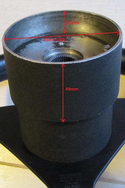

underthetire I ended up making my own adapter. I cut the origin... Jan 11 2011, 02:46 PM
Lou W
I ended up making my own adapter. I cut the origi... Jan 11 2011, 05:29 PM![]() ![]() |
