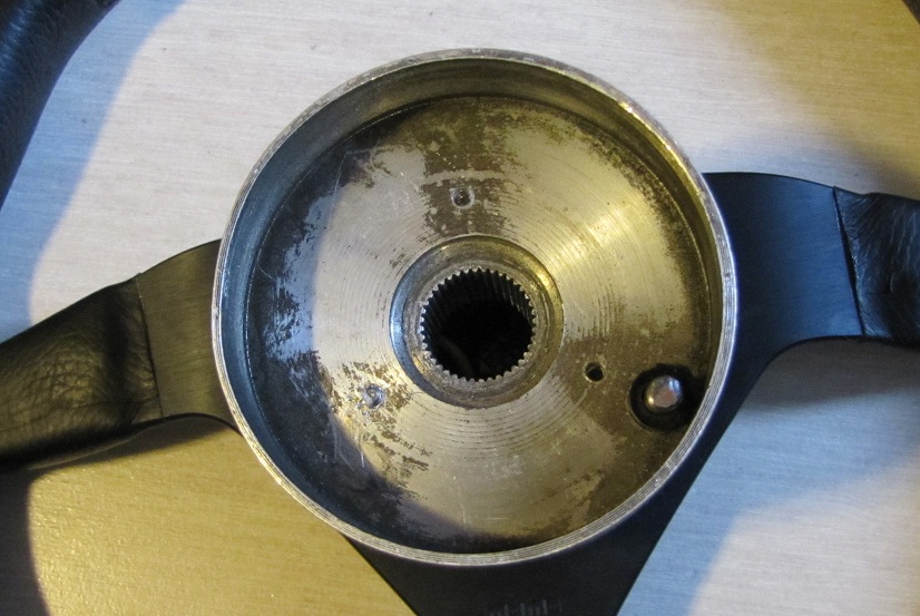

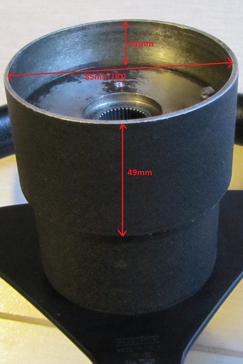

Can someone confirm this is the adapter that should fit early (70-71) model?
I got it in my 74 but it blocks the high beam lever. I think it should find a better home.
