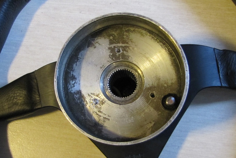

Can someone confirm this is the adapter that should fit early (70-71) model?
I got it in my 74 but it blocks the high beam lever. I think it should find a better home.

QUOTE(Valy @ Jan 11 2011, 12:03 PM) *
