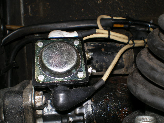

detoxcowboy
post Jan 12 2011, 12:33 PM
Posts: 1,294
Joined: 30-January 08
Member No.: 8,642
Region Association: Africa
I made this relay for the starter using a 914 headlight relay mount. This should amplify the voltage at the soleniod by avoiding the voltage drop from the igniton switch. Also embedded in the wiring is a rectifier diode in line with the igniton switch/starter key to protect the ignition switch from the 350V EMF pulse comming from the starter solenoid when the current collapses.. (link to article below...see bottom of page).
Linky-
http://www.pelicanparts.com/techarticles/m...tarter_diag.htm
** side note,** I do not have a starting problem, in fact I ripped out the Bosch Hard Cure when I got the car so I could ensure proper function as per desighn, but I have had to switch out a relatively new ingnition switch (a year old or less) that left me with out warning stranded at a liquor store. Also when I was in below freezing/snow temps my Optima Battery was dying and before I figured that issue out, I tried applying 12 volts directly from the battery to the solenoid and definately noticed an immeadiate improvement in its desire to start even form a dying battery that could not hold a full charge any longer.
I usually do not share my 914 (%$& alternative ideas but thought using this set up would allow me to use the 914 round relays and also install a starter relay mounted in the engine compartment rather than the......dangling open environment the Bosch Hard Start Cure seems to be installed more often than not..
total cost a few dollars.. Anyways just a thought I thought I would put out there.

dr914@autoatlanta.com   very nice factory looking piece! I am sure th...   Jan 12 2011, 12:42 PM
SirAndy   very nice factory looking piece! I am sure th...   Jan 12 2011, 12:46 PM
KELTY360   Nice looking solution Cowboy. Where are you mounti...   Jan 12 2011, 02:56 PM
detoxcowboy   ]   Jan 12 2011, 04:21 PM
detoxcowboy   RE: Starter Relay (Factory Styled) w/ Install Pics   Jan 12 2011, 04:26 PM
detoxcowboy   :D   Jan 12 2011, 04:42 PM
underthetire   Looks very nice. Just a side thought, I wonder if ...   Jan 12 2011, 05:38 PM
detoxcowboy   Looks very nice. Just a side thought, I wonder if...   Jan 12 2011, 06:14 PM
Spoke   You would want to mount the relay as close to the ...   Jan 13 2011, 07:51 AM
detoxcowboy   You would want to mount the relay as close to the...   Jan 13 2011, 08:27 AM
SLITS   I use a "Ford" style solenoid hung near ...   Jan 13 2011, 07:58 AM
zonedoubt   I use a "Ford" style solenoid hung near...   Jan 13 2011, 03:01 PM
markb   I use a "Ford" style solenoid hung nea...   Jan 14 2011, 12:18 AM
detoxcowboy   RE: Starter Relay (Factory Styled) w/ Install Pics   Jan 13 2011, 11:38 AM
Tom   Detox, Darn you, now I have no reason not to g...   Jan 13 2011, 11:55 AM
detoxcowboy   Detox, Darn you, now I have no reason not to ...   Jan 13 2011, 12:15 PM
detoxcowboy   RE: Starter Relay (Factory Styled) w/ Install Pics   Jan 13 2011, 01:15 PM
detoxcowboy   So far it works great, I am not having any proible...   Jan 13 2011, 11:52 PM
