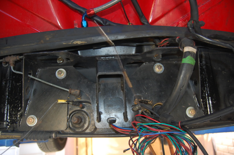

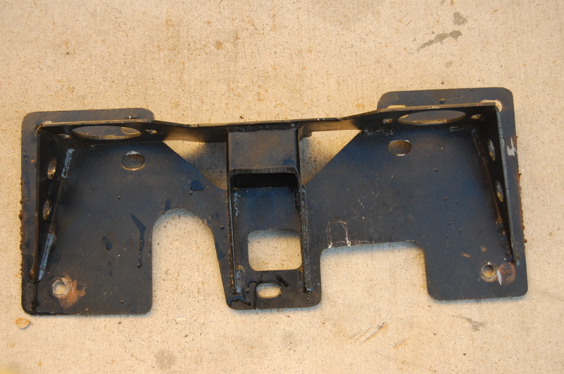

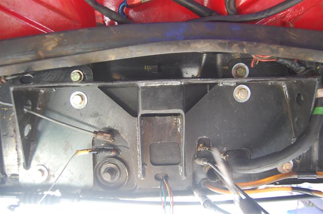

First, my welding sucks eggs, big time. So, now that you know that, the motor mount is in. First I bolted it in with six grade eight bolts to 100 ft lbs of torque. The Captain, John Larson, and Gill Paszek instisted that the motor mount still needed to be welded in, so I welded it in. Did I mention my welding sucks. Well, it's welded in really good, it's just not so pretty. But this motor mount isn't going anywhere.
