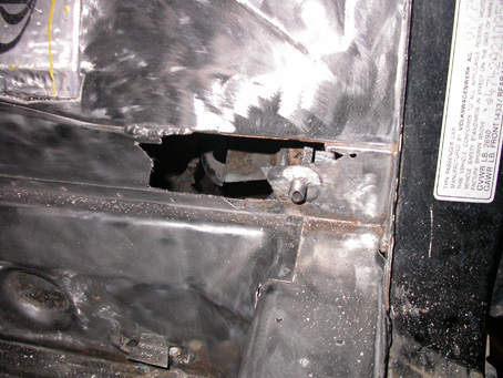

compared to others, this chassis is fairly solid. that does not mean it is free of isuses. the main issue I saw that needed correction was that the rear area spot welds were letting go. once this happens, things start to move and stress turns to cracks and further seam separation. most of the rust came from the "rust incubators AKA rocker panels

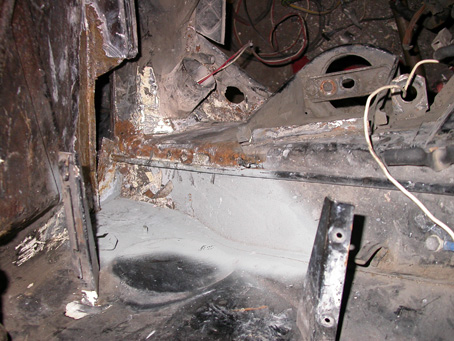

karlo   Digging into rust issues while I'm considering...   Nov 29 2010, 10:10 PM
SirAndy   The driver's side hell hole has had standing w...   Nov 30 2010, 12:41 AM
karlo   There are actually two plastic plugs, one larger ...   Nov 30 2010, 07:35 PM
brilliantrot   I would also suggest that you replace the main sha...   Nov 30 2010, 12:38 AM
karlo   Pictures of the hell holes, as promised, treated a...   Nov 30 2010, 09:20 PM
karlo   Rust removal continues. Have been derusting the he...   Dec 15 2010, 09:44 PM

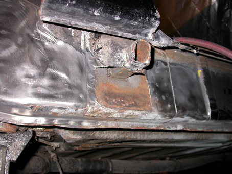

sean_v8_914   ...and the vertical wall (inner wheel house)behind...   Dec 16 2010, 08:16 AM
sean_v8_914   snap a photo of the seam under teh hell hole. the ...   Dec 16 2010, 08:25 AM
karlo   Got a better picture of the underside of the LHS l...   Dec 16 2010, 01:28 PM

sean_v8_914   it is MUCH better to do the chassis work while the...   Dec 17 2010, 08:31 AM
sean_v8_914   exp   Dec 17 2010, 08:34 AM
sean_v8_914   I like this one too but doesnt show area of discus...   Dec 17 2010, 08:36 AM
sean_v8_914   since we are talking about messed up chassis...cen...   Dec 17 2010, 08:37 AM
roadster fan   This is not the best pic but may be helpful Jim   Dec 18 2010, 05:13 PM
karlo   This is not the best pic but may be helpful Ji...   Dec 18 2010, 07:07 PM
sean_v8_914   thank you. that view shows the two different layer...   Dec 19 2010, 08:38 AM

sean_v8_914   compared to others, this chassis is fairly solid. ...   Jan 22 2011, 11:02 AM
sean_v8_914   the rust seems to weaken the spot welds. then they...   Jan 22 2011, 11:09 AM
