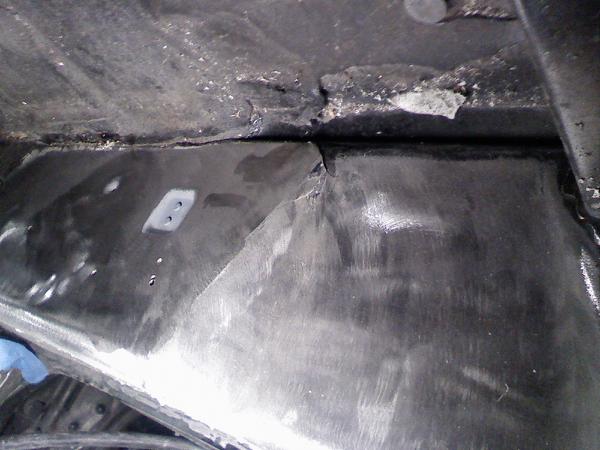

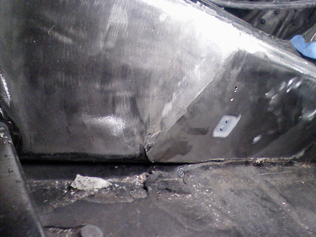

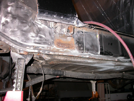

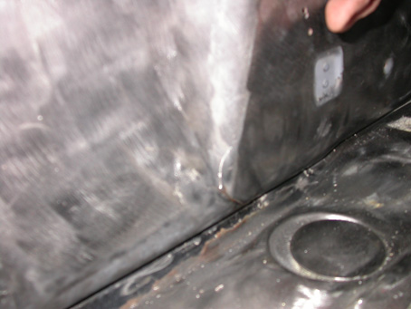

the rust seems to weaken the spot welds. then they move and pull untill they start to separate.
I drill w spot weld bit in between the original spots, then I add new spot welds and stich it together. this spot weld issue is most common on teh suspension ears. once they come apart, the cracks turn to rips. this chassis was in teh infancy stage of this so there were no rips yet. inside the ears were fairly clean, a rare find on right side
